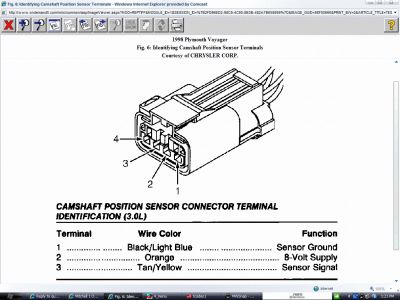

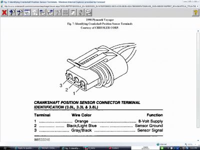

1998 Plymouth Voyager. intermittent problem, replaced cam and crank sensor, coil, plugs, wires, fuel filter, EGR valve and solenoid, went through wiring under battery and everything looks good but still cuts out and gives code p1391.
Please help!

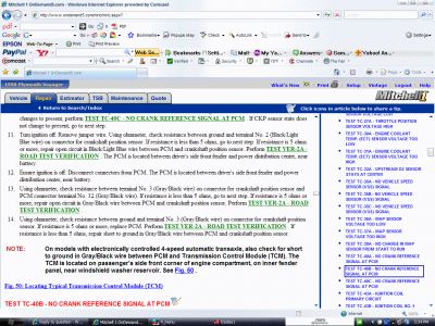

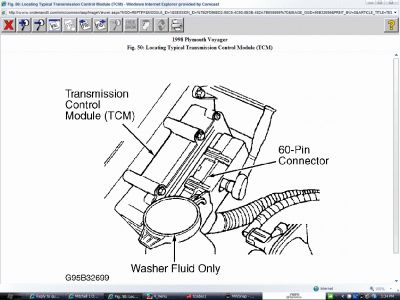

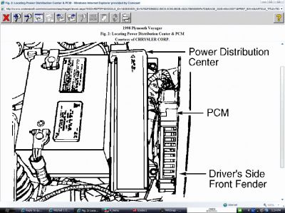

If you have changed both sensors you will need to track down the wires. I will email the wires to test and the procedures. This will only tell if wires are bad, not the sensors:
https://images.2carpros.com/forum/automotive_pictures/62217_CKP_1.jpg
https://images.2carpros.com/forum/automotive_pictures/62217_CMP_1.jpg
https://images.2carpros.com/forum/automotive_pictures/62217_PCM_2.jpg
https://images.2carpros.com/forum/automotive_pictures/62217_TCM_1.jpg
