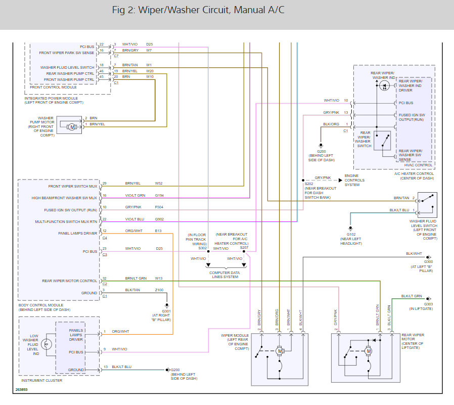

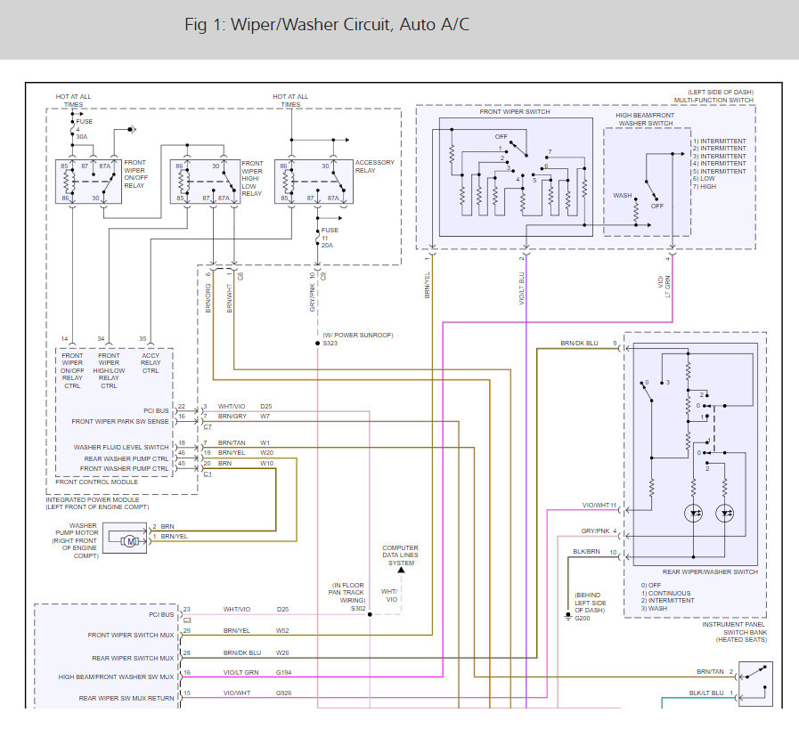

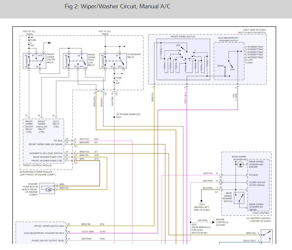

Washer is not working. I can't locate a fuse for the pump. Q1 Is there a fuse for the pump? Q2 where is the pump located?
Jan 11, 2010 at 11:29 AM
CARADIODOC
  • 34,321 POSTS

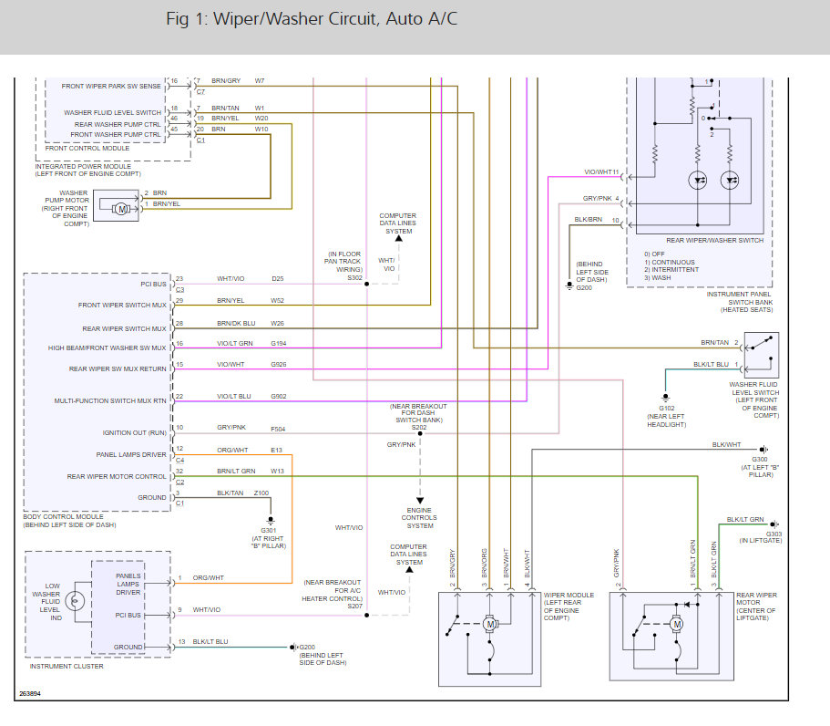

Washers don't work anymore with a simple fuse. Try disconnecting the battery for a minute to reset the TIPM. There isn't a separate fuse. Here is the location of the pump motor so you can see if it is getting power and the wiper wiring diagrams so you can see how the system works. Check out the diagrams (Below). Please let us know what you find. We are interested to see what it is.
Jan 13, 2010 at 6:23 AM
JOE BAILEY
I have no separate fuse on my 2006 town and country. Its probably tied in with the relay switch . To locate the pump, turn the front tires all the way to left. remove the 2 lower tire splash shield screws on front passenger side and pull back that rubber flap. You will see the pump at the bottom of its plastic reservoir. Simply disconnect wires and pull it straight out.
