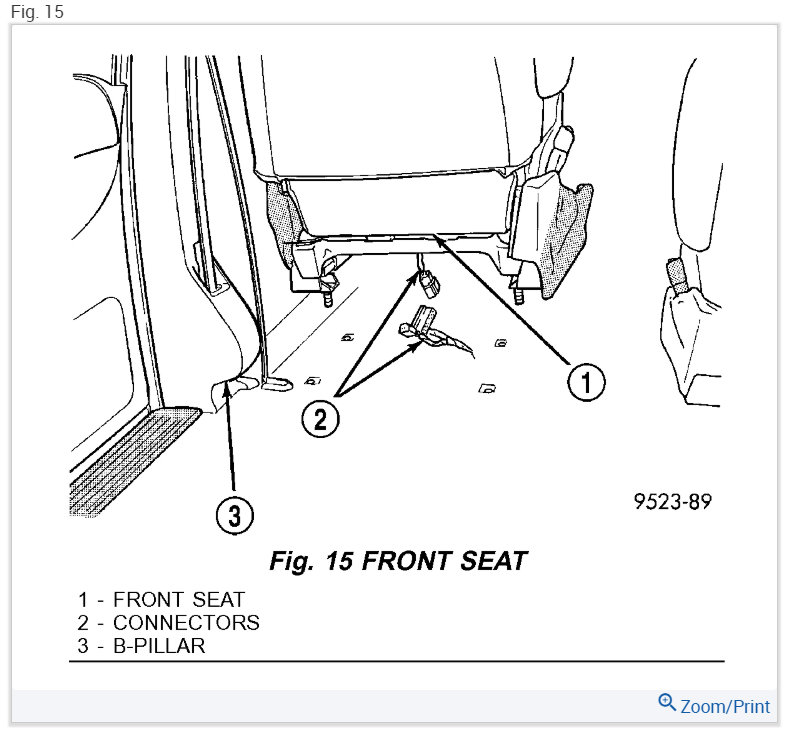

How do I remove my front seats?
Feb 28, 2010 at 3:27 PM
  • 110,194 POSTS
These seat are bolts from the bottom. I believe it will be 15mm. Here are diagrams below to show you how to remove the seat.
