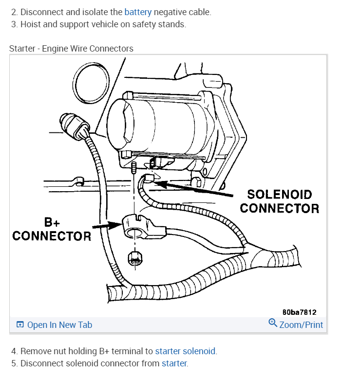

I have a 2003 town and country and it has a no crank symptom, the starter relay is clicking and the van has power to all the accessories. It stalled out on the way into a parking lot and then after about a half hour it started but soon after cut out again and wouldn't crank. The battery is good, I swapped some of the relays and that didn't change anything. I read online about the crankshaft sensor, any suggestion?
Saturday, July 24th, 2010 AT 10:00 AM
KEN L
  • MASTER CERTIFIED MECHANIC
  • 49,775 POSTS

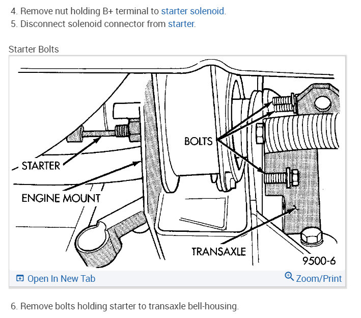

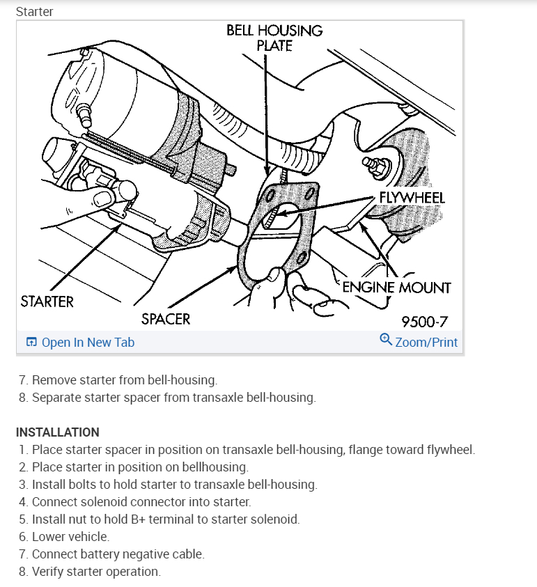

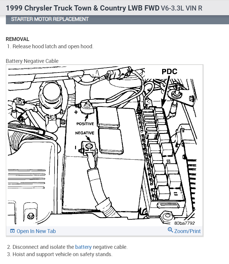

The crankshaft sensor will not make it click but a bad starter motor would but just top be sure this guide can help you test the starter motor and just in case I have left how to change the starter motor out in the diagrams below.
Check out the diagrams (Below). Please let us know what you find.
