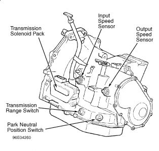

https://www.2carpros.com/forum/automotive_pictures/99387_Graphic9_45.jpg
Suspect tranny solenoid pack
also check speed sensors
tranny codes will help
