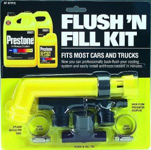

No matter what, you will lose some fluid. Instead of removing the hose ends at the heater core, I would remove the hose from the other end from the engine. It is a little harder, but it will be a lot less messier. Get ready with some plastic bags and rubber bands. When you pull a hose out, cover the nipple with the plastic bag and wrap the rubber band around it. Let the fluid in the hose to drain into a bucket or something. Once a hose is removed, attach a T-fitting like this one
https://images.2carpros.com/forum/automotive_pictures/55316_pstafkit_1.jpg
and a garden hose to the other hose, and push all the junk out of the heater core. You may also want to consider refilling with new fluid...
