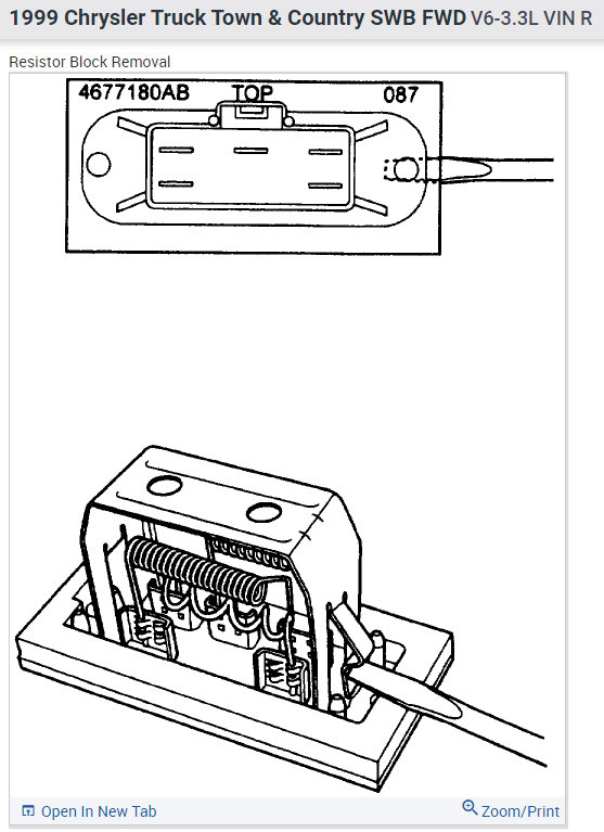

What do I have to remove to replace the blower motor resistor?
Thursday, May 6th, 2010 AT 1:23 PM
SQM
  • 6,383 POSTS

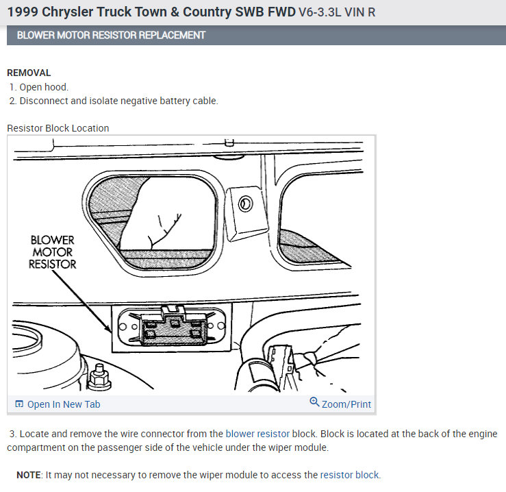

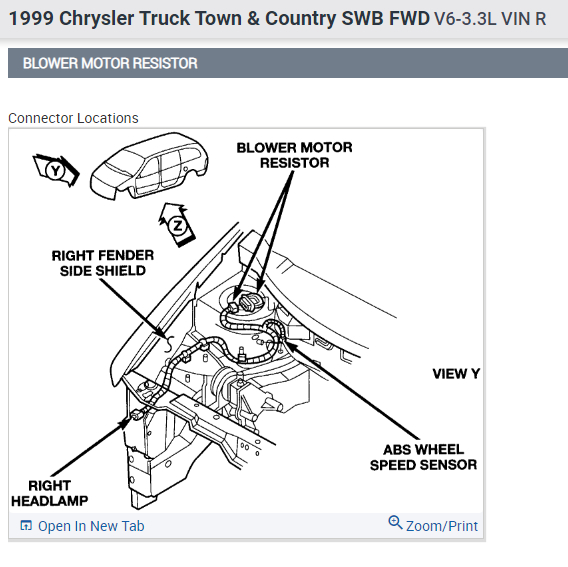

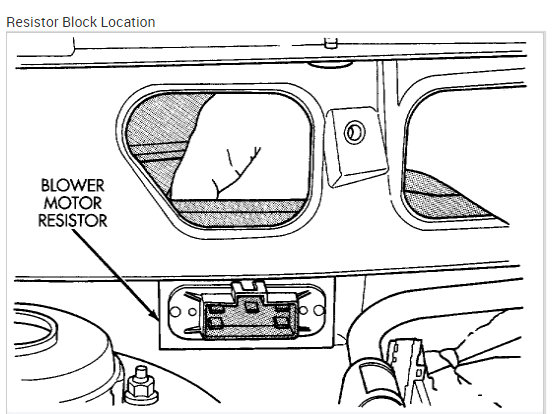

Replacing the blower motor resistor is a simple procedure on this vehicle.
The resistor is located at the back of the engine compartment on the passenger side of the vehicle. Right under the wiper module (see diagram).
Before getting started disconnect the negative battery cable.
Using a flat head screw driver you will be able to push on the clips that holds the resistor in place. Gently push and lift upward to remove the resistor.
