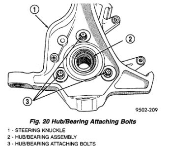

how do i get the front wheel bearings out

Hello - It looks like on your vehicle the hub and bearing are one unit. They are to be replaced as one. It looks like depending your modes, (coupe, convertible etc) Auto Zone and O'Reilly's has these for about $80.00 and up.
https://images.2carpros.com/forum/automotive_pictures/248015_1_57.jpg
HUB / BEARING - FRONT DESCRIPTION The bearing used on the front hub of this vehicle is the combined hub and bearing unit type assembly. This unit combines the front wheel mounting hub (flange) and the front wheel bearing into a one piece unit. The hub and bearing assembly is mounted to the steering knuckle and is retained by three mounting bolts accessible from the back of the steering knuckle. The hub and bearing unit is not serviceable and must be replaced as an assembly if the bearing or the hub is determined to be defective. The wheel mounting studs used to mount the tire and wheel to the vehicle are the only replaceable components of the hub and bearing assembly. OPERATION The hub and bearing has internal bearings that allow the hub to rotate with the driveshaft and tire and wheel.
