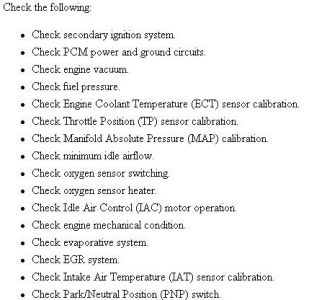

I have a LXI Coupe and when I start stopping it will die. My teacher says it could be a injector, but it doesn't throw a code. Are there problems with fuel injectors on 1999 Chrysler Sebring LXI?

After 90K miles, there will be (some) problems with injectors. But I wouldn't replace the injector just yet. Suppose, as with most people just spending the money installing unnecessary replacement, you want to replace the injector. Which injector will you be replacing? Just one, or are you doing all six? Do you my point?
Why don't we follow the proper diagnostic. Do not skip any step.
https://www.2carpros.com/forum/automotive_pictures/55316_99sebringstumble_1.jpg

It doesn't have a vacuum leak or anything, it does idle low however

Have you finished checking the rest of the steps? When you said low idle, how low is it in terms of rpm? 500, 600, 700 rpm? Is it constant at that said speed, or does go up and down, up and down? Listen by sound, and look by the needle on the gauge.
