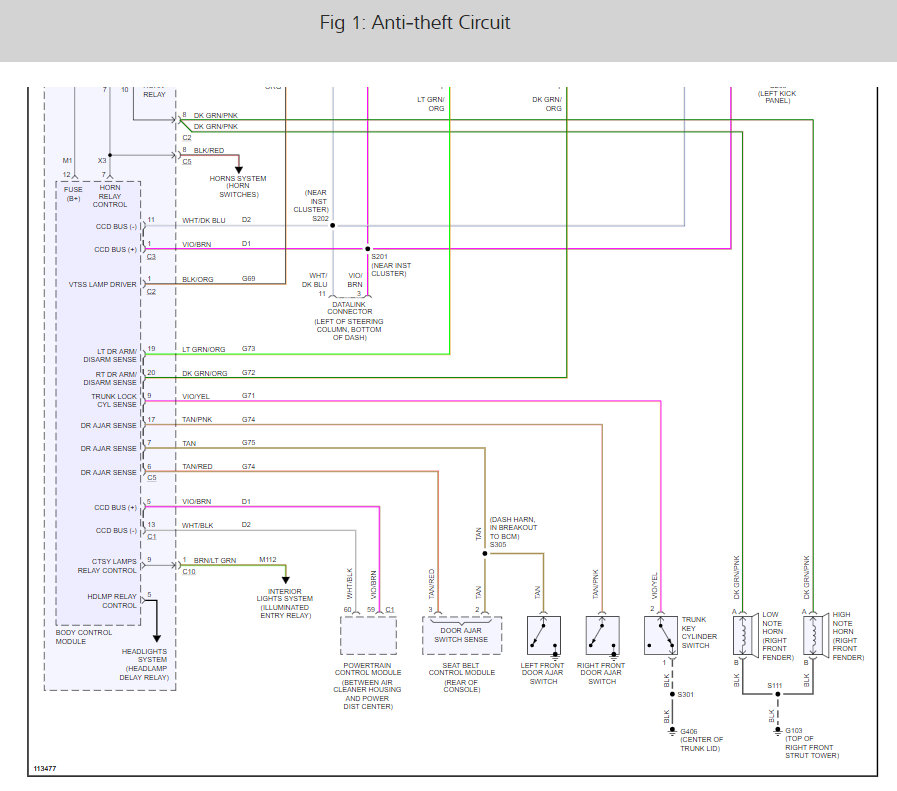

The car will not start due t the ALARM SYSTEM, we thought it was the battery and replaced it and it started but then would not start again, alarm system not allowing to car to start.
Monday, April 13th, 2009 AT 8:21 AM
14 Replies
CARADIODOC
  • 33,916 POSTS
Are you unlocking it with the key fob or the key? If the key in the lock cylinder, try it in the other front door. If that works, the switch in the left door is disconnected, defective, or there's a broken wire between the two door hinges.

Use the key to lock and unlock the DRIVER door. That should reset the system. If I doesnt then I would replace the drivers door latch because there is a switch inside the latch that goes bad which cases the alarms to go off.

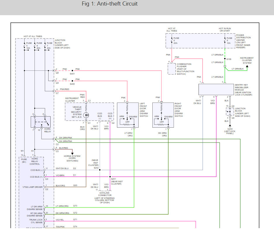

What happens is the driver door latch/pin switch wears out so it doesn't work the micro switch inside the latch so the alarm thinks the door is still open. To be sure we can do a test to see if the switch is being closed. here is a guide and the security system wiring diagrams to help you see how the system works and which wires to test:

So today I unhooked negative cable. Let it sit for 20 minutes. Then got it to start. It ran great for 5 minutes or so then just shut off. Started right back up. Ran for 5 minutes and shut off again. Now it wont start again. Did the battery thing again, the key thing, got the alarm to turn on and go off but wont fire just cranks. I am thinking the key maybe? He only has one and it says valet key on it. Any suggestions?
Saturday, August 10th, 2019 AT 9:05 PM
KEN L
  • MASTER CERTIFIED MECHANIC
  • 48,363 POSTS
Yep, it sounds like you have the wrong key or it lost its programming which happens. When it wont start does the security light flash? If so this is what is happening. I shop can reprogram a key for you it should cost about $130.00, let me know.
