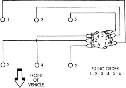

I put new spark plugs and wires.It still missed out so I put a new rotor button on and still missed out so I put a new distributor on it started but still was missing so I took out distributor and reinstalled it and it wouldn't even fire so i took it out and put it back again and now it fires but won't start.What could be wrong with it the distributor only goes in one way so I know it's not wrong.Please help me?

Make sure you have the firing order of plug wires correct.. Firing Order: 1-2-3-4-5-6 Distributor Rotation: Counterclockwise

Firing order is correct.Did I mention car had a bad miss before I changed anything.

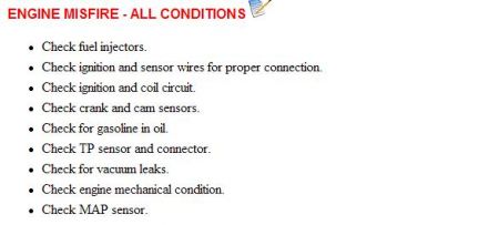

Several things can cause a misfire or no fire situation. You need to inspect the following components..
https://images.2carpros.com/forum/automotive_pictures/261618_Noname_291.jpg
Post results and I will follow up. Thanks for using 2CarPros.com!
