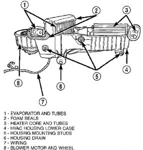

I am replacing the heater core. Will I have to remove the dash to be able to get to it? If not, how do I get to it?

IT's 6 hour job for a technician. IT comes out from the inside. The HVAC housing needs to come out and it's behind the dash panel.
https://images.2carpros.com/forum/automotive_pictures/30961_hc_1.jpg
https://images.2carpros.com/forum/automotive_pictures/30961_mitchel_10.jpg
I can give you more steps that may help you get through this. If you not up to the challenge, it will cost you dearly to bail halfway through and have a shop get a jigsaw puzzle.
