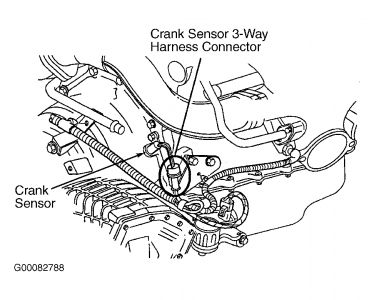

Its a dodge product The crankshaft position sensor location see below
https://images.2carpros.com/forum/automotive_pictures/12900_cps_47.jpg
Jul 9, 2010 at 3:08 PM
VCALKINS
  • 9 POSTS
ok so i unhook this? how do i know if its bad or not?
Jul 9, 2010 at 3:18 PM
  • 75,992 POSTS
Use a multimeter to read the resistances on the CPS
