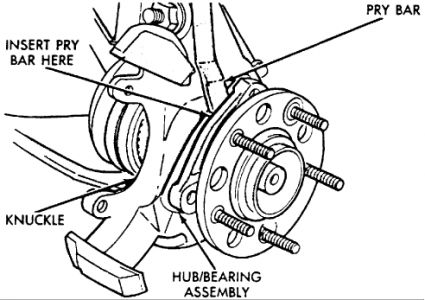

Ok I took it to a shop today and to make it short, the wheel bearings are bad. I thought there were ok, but after inspection, and feeling the red hot hub.....yeah. So any help on dissasembly, I have all the bolts loose, is the wheel flange pressed on? I have access to a puller if so, or do i just need to spray it with penetrant and coax it with a hammer and torch? Anything else I need to watch out for in the replacement. I am doing both sides. I will have the parts tomorrow am am trying to dissasemble so I can get Iback on the road.
Nov 5, 2008 at 4:16 PM
IMPALASS
  • CAR REPAIR CONTRIBUTOR
  • 3,112 POSTS

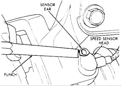

Hello - Glad you found the problem. I have attached the info you requested. Just a couple of notes, looks like you can use a pry bar but the note tells you to be careful not to bend the finger. Also, it tells you to always use a new stub shaft nut when installing. Careful on the sensor.....they can be a bear. I have tore them up before as they almost weld to the knuckle. Some of them I have been able to use the same size socket and on the back side, tap the socket and that drives it out. That's all I got on this.........good luck. Raise and support vehicle then remove tire and wheel assemblies. Remove front caliper assembly and rotor from the steering knuckle as outlined in the "Disc Brakes" unit repair section. Remove ABS speed sensor as follows: Remove bolt retaining sensor to steering knuckle.
https://images.2carpros.com/forum/automotive_pictures/248015_1_27.jpg
Slide sensor from steering knuckle. If sensor is stuck into knuckle do not use pliers on sensor body. Using a suitable punch, tap on sensor body ear to rock sensor loose from knuckle. Remove hub and bearing to stub axle retaining nut.
https://images.2carpros.com/forum/automotive_pictures/248015_2_19.jpg

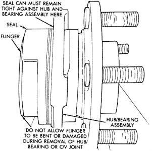

Remove hub bolts, then remove hub and bearing assembly from steering knuckle by sliding it straight off end of stub axle. If metal seal on hub and bearing assembly is seized to steering knuckle and becomes dislodged on hub and bearing assembly during removal, or when removing hub and bearing, the flinger disc on hub becomes damaged, hub and bearing assembly must be replaced.
https://images.2carpros.com/forum/automotive_pictures/248015_3_16.jpg
If hub and bearing will not slide out of knuckle, insert a pry bar between hub and steering knuckle and gently pry hub and bearing from knuckle. Reverse procedure to install, noting the following: Always use a new stub shaft nut when installing. Tighten stub shaft nut, then lower vehicle and, with brakes applied, torque stub shaft nut to 120 ft-lbs .

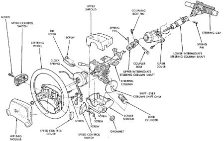

OK wheel bearings are replaced, it rides smooth. New problem, when I hit 70 the steering column starts to bounce up and down, sometimes worse than others. It does go straight down the road if you let go of the wheel. I did not have them check the wheel balance when I had the bearing problem discovered. I suppose that is what youre going to tell me next. I did inspect the tires, and so did the technician. No evidence of thrown weights , and no seperated belts. I'm going to drive it down the interstate this afternoon and see how bad it is. I live in the country and the roads are not the best. So maybe a smooth road will give a better idea. Too bad my grandfater did not believe in preventative maintenance.

Hello - akamario When you say the steering column starts to bounce up and down, are you talking about the steering wheel level adjustment is not holding the steering wheel tight in a proper position or you can move the entire column in and out? I would suggest you check all of the connections from the steering wheel down to the rack. There may be a grease fitting where the column connects to the rack, lube it. Ensure it is secure all the way. Inspecting the tires is good.........but putting them on a high speed balance is the best thing. Even though it may have not thrown a weight that doesn't mean the tire is properly balanced since it has been sitting and even though you have been driving it. If you don't get the smooth ride you are looking for - go for the high speed spin balance.

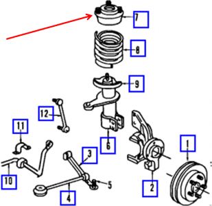

When I steer to the right at 60moh and above I get a rapid "thump thump thump" I called the dealer and they told me to spray WD-40 on the strut mount? I looked and Im not sure what I'm aiming for. I got the repair history for the car. evidently the struts are not new as i was told depite still being new looking. It does have new tie rods ends and everything else in the front end is still tight, so what is this stut mount that I need to juice up woth WD-40?

Hello - akamario, I have attached a pic of the mount. It is the very top item. I would make sure all the nuts/bolts are good and tight with the weight on the wheels. Ball joints can be an issue too. But.....I am still going to go back to that high speed balance on the tire thing. All 4 and then if you still have the sound move the rear to the front. You would be amazed at noises etc that tires can have/make.
