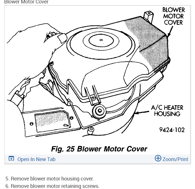

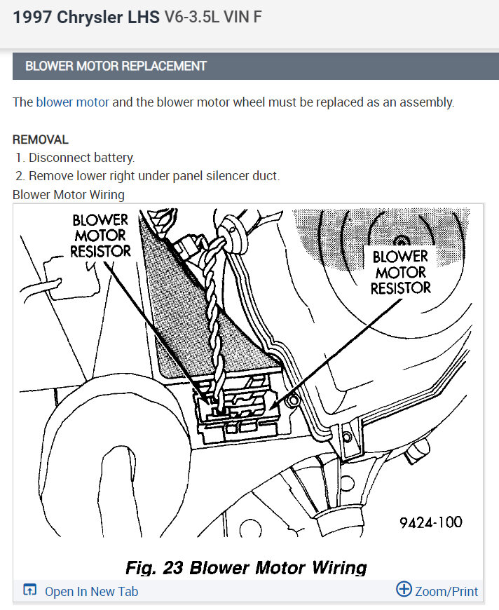

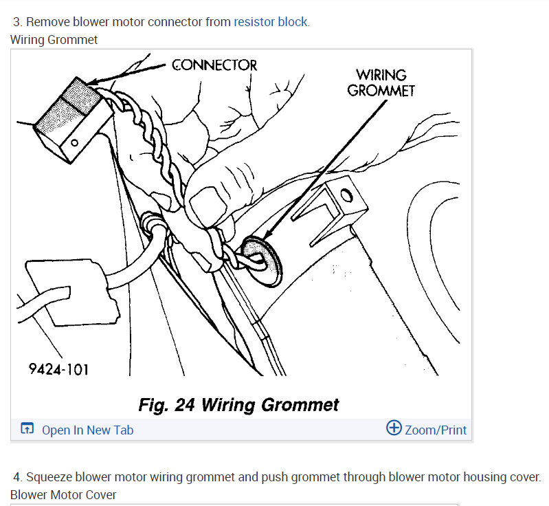

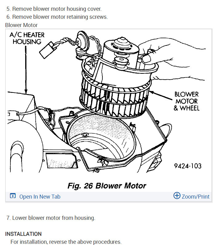

You have a short circuit in the HVAC electrical system and a wheel speed sensor that needs to be replaced, Usually when the heater fuse pops the blower motor resistor or the motor itself needs to be replaced. Here is the location so you can swap them out which should fix the problem. Check out the images (below). Let us know how it goes
