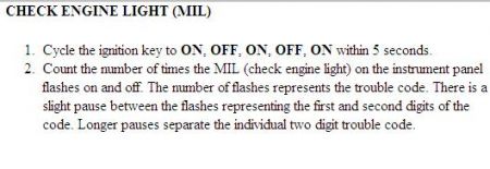

Hello, how does it act at highway speed? Any codes?
https://images.2carpros.com/forum/automotive_pictures/170934_trouble_codes_mil_1.jpg
The above info is how to access some codes.

I checked the codes and it reported 12 55
Thanks Again
Aug 6, 2009 at 9:43 AM
JDL
  • 16,098 POSTS
The codes didn't show anything. Code 12 means the battery has been disconnected at some point in the past. Code 55 is end of message. Is the idle speed too low in drive? If you open the throttle does the problem go away?
