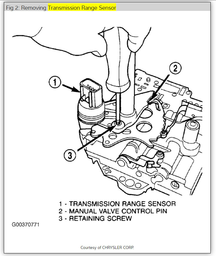

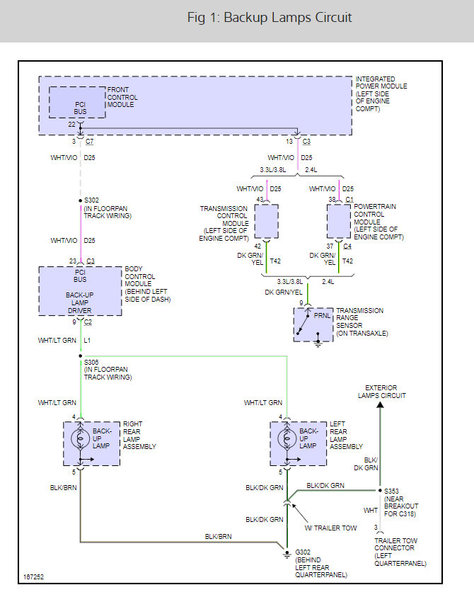

Electrical problem 6 cyl Two Wheel Drive Automatic 160000 miles
My reversing lights do not illuminate when I am in reverse gear. Also, my reversing sensors do not work. I have checked all the bulbs and they still work, I have also checked the fuses in the fuse panel and they are all okay. Any advice you could give would be great.

This revers light system runs though the BCM and is triggered by the transmission range sensor. Please check for signal out the to switch.
Here is a guide and the wiring diagrams for the reverse lights so you can see how they work and the location of the switch.

Thanks, I ended up replacing the range sensor and the reverse lights came back. I love this site.
