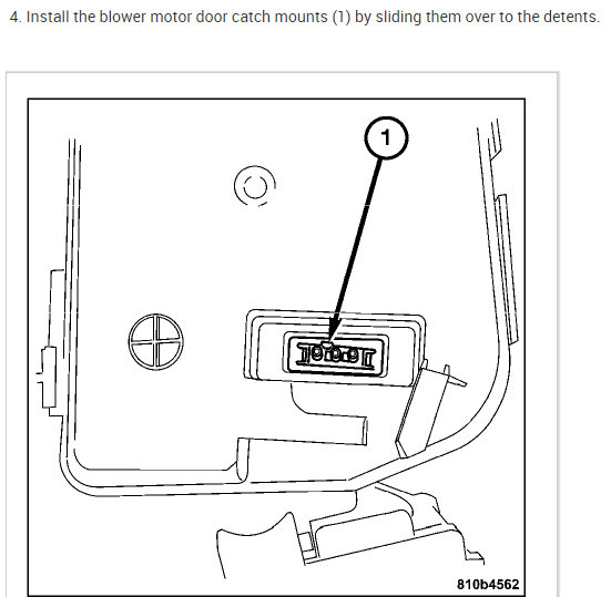

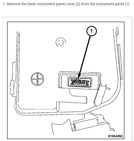

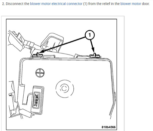

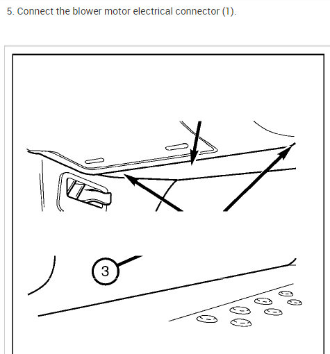

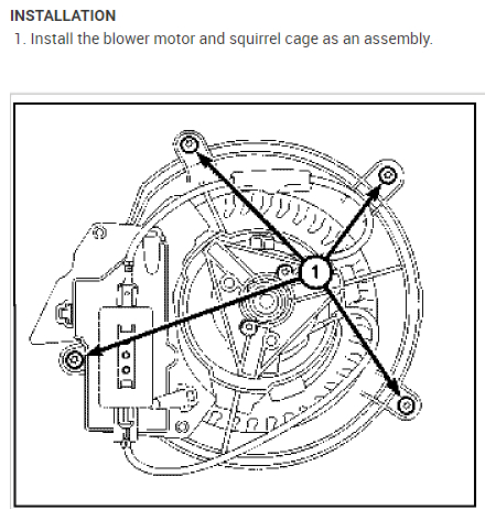

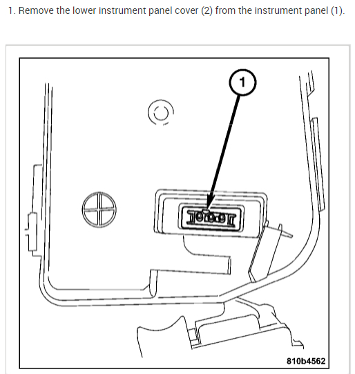

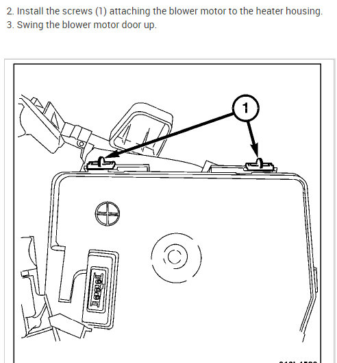

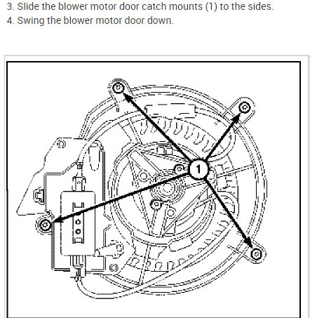

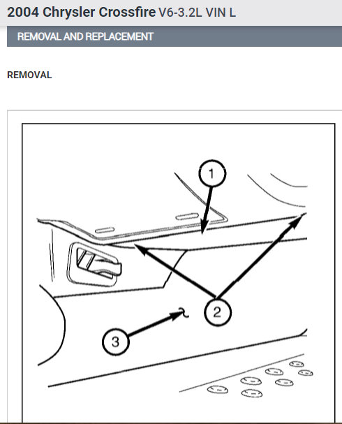

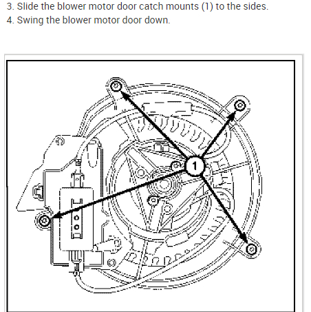

what could be the cause of the a/c & heater just stopped blowing any type of air. no defrost either
Jul 19, 2009 at 12:29 AM
DANNY L
  • 5,648 POSTS
Hello, I'm Danny.
Here is the information you requested. It does sound like you might have a failed blower motor. Here is a tutorial showing how to replace a blower motor.:
https://www.2carpros.com/articles/blower-fan-motor-works-on-high-speed-only
I've attached picture steps below showing how to replace the blower motor on your Crossfire. Hope this helps and thanks for using 2CarPros.
