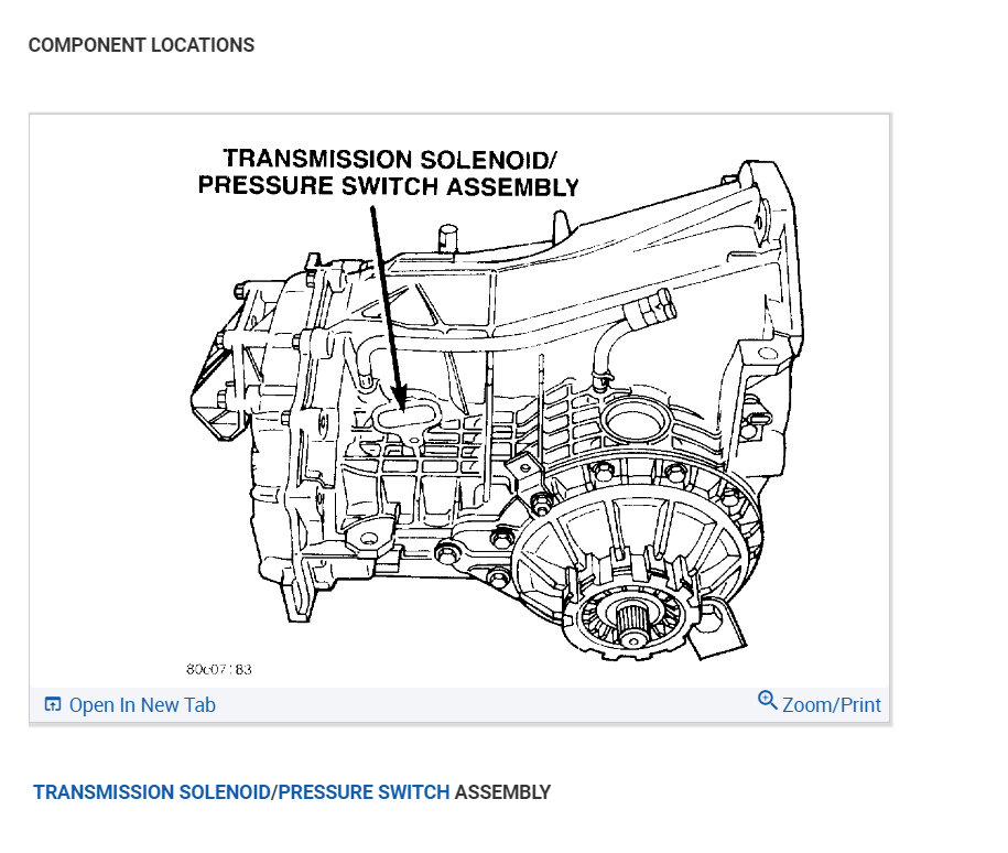

These are two different problems but the one that stands out is the
P0871 trans fluid pressure
I would check the fluid level which can cause the code and if okay replace the pressure sensor on the transmission here is the location so you can check it out.

These codes 732 & 871 would indicate the the solenoid pressure switch assembly above the valve body which is accessed by removing the valve body through the transmission oil pan(from what I gathered from the internet. My $75.00 code reader didn't pick any other codes up.
I changed transmission fluid and filter- Still same codes. So I finally broke down and took it to a mechanic, I told the mechanic the codes- I figured if he don't know what they mean then I don't want him working on my car. If the first this out of his mouth was a rebuild same thing. He did know what they meant and said that they were probably the solenoids above the valve assembly. So I said ok let's get started. He then hooked his code reader up and an additional code was found:
P0944 Hydraulic Pressure Unit Loss of Pressure.
Bingo- that would explain the other code problems- transmission oil pump went bad. Had to replace- Simple? Na- have to rebuild the transmission and replace the solenoids while at it. But I'm ok with that- That did appear to be the problem and it was not just the first thing out of his mouth. I believe to have gotten a good deal at only$1,400.
