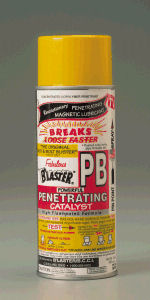

No special tools, just your basic automotive tools. You will need (if I remember correctly) 17mm socket for the caliper bolt and 19mm for the caliper bracket bolt. Prepare yourself to have these two brake accessories handy. To loosen your rotor from the hub assembly
https://images.2carpros.com/forum/automotive_pictures/55316_16pb_4.jpg

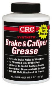

To apply on your metal-to-metal contact points when replacing the pads.
https://images.2carpros.com/forum/automotive_pictures/55316_05359_3.jpg
