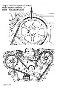

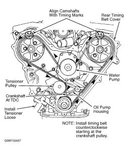

How do you set the timing on this vehicle?
