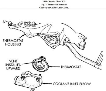

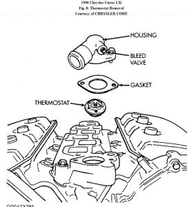

where is the thermostat located? could you send diagram.

MERLIN2021
  • 17,250 POSTS
Removal & Installation (3.3L & 3.5L) 1. Drain coolant below thermostat level. Remove thermostat housing bolts. Remove thermostat assembly. Clean gasket surface. Install thermostat into intake manifold recess. Using new gasket, install thermostat housing and mounting bolts. See Fig. 8 . 2. Fill cooling system. Start engine and warm to normal operating temperature. Bleed air from system. See COOLING SYSTEM BLEEDING . Check coolant level.
https://images.2carpros.com/forum/automotive_pictures/62217_cirrus_1.jpg
Apr 21, 2010 at 1:34 PM
BOBBY LANCASTER
  • 87 POSTS
its a 2.5 eng. not a 3.3. or a 3.5
Apr 22, 2010 at 6:59 AM
MERLIN2021
  • 17,250 POSTS
I thought you said it was a V6? Removal & Installation (2.5L) 1.Drain coolant below thermostat level. Remove coolant recovery system hose. Remove thermostat housing bolts. Remove coolant inlet elbow from thermostat housing. Remove thermostat assembly. See Fig. 7 . 2.Install thermostat into thermostat housing recess. Ensure vent in thermostat body is installed facing upward. Using new gasket, install coolant inlet elbow and bolts. Tighten bolts to 132 INCH lbs. (12 N.m). 3.Fill cooling system. Start engine and warm to normal operating temperature. Bleed air from system. See COOLING SYSTEM BLEEDING . Check coolant level.
https://images.2carpros.com/forum/automotive_pictures/62217_25_1.jpg
Apr 22, 2010 at 2:30 PM
