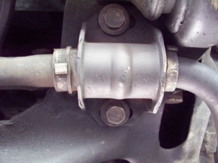

So... do you think these are the right ones? Year One has nothing close to this. Here's a picture of one underneath my car.

That dimple in the middle of the bracket will hold the bushing in place. I suspect the clamps on the sides are to help keep water out.
The left clamp has the crimp I was talking about sticking straight up toward the camera. It looks like these are the right bushings for the application but they will probably look a little different.

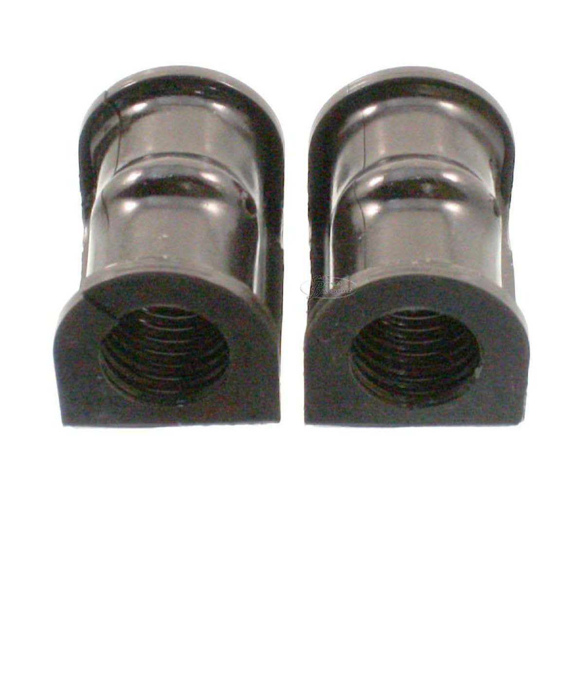

Yeah. Here's a shot of the new bushings where that dimple would go. Now, to replace these bushings do I still want to jack it up by the cross-member? Can we have a phone conversation about this. I am willing to make the long distance call if you feel you can't. My number is 323-924-5589, I am in LA. Where are you located? My name is Saro and I can't thank you enough for your knowledge.

I don't think you're going to have to disassemble anything other than the bracket. When the car is jacked up by anything other than the lower control arm, that arm will hang down and there will be no pressure on that bushing. You should be able to pry the bushing out of its pocket very easily. Since the new bushings appear to have a slit in the side, it should bend open to pop it around the bar. You might have to discard the two clamps and a rubber insert if that's what's in there. You would be able to tell by the inside diameter of the new bushing. My guess is these new bushings don't need those clamps because they have a lip on each end to keep them in position. Since they are obviously a different design in that respect, they are probably different where they contact the bar too. The ridges in the center suggest all of the flexing the bushing needs to do is supposed to occur in the center, or the bar is intended to rotate inside the bushing. Polyurethane can hold up a long time to that.
If you do have to reuse the clamps, stop by any mechanic who does front end work and ask to see what the special pliers looks like and how the clamp works.
