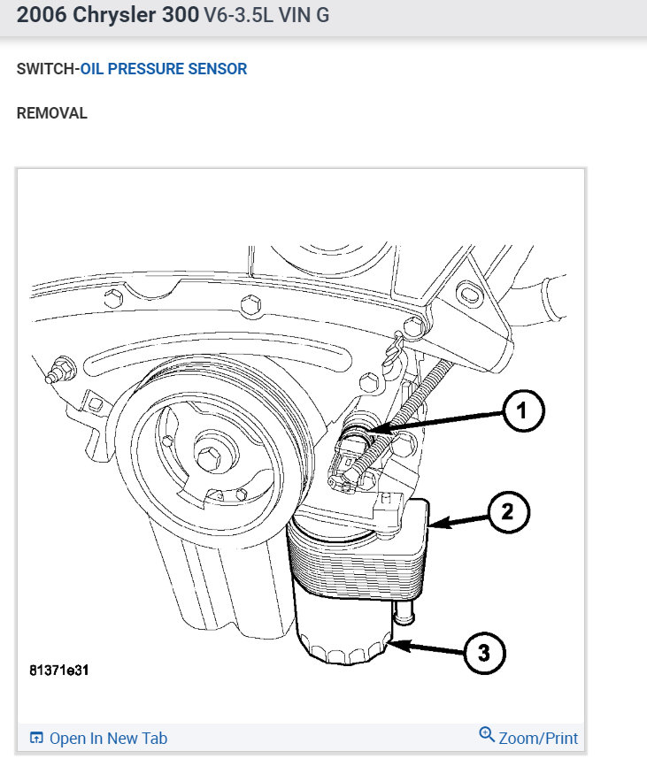

where is the oil pressure switch ..i'm going to replace mine.
May 7, 2010 at 2:26 PM
BLUELIGHTNIN6
  • 16,542 POSTS
oil pressure sensor is on right front of engine or lower right front of engine. Check out the diagrams (Below). Please let us know if you need anything else to get the problem fixed.

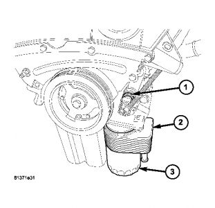

Oil pressure switch location right side engine.
https://images.2carpros.com/forum/automotive_pictures/198357_Graphic_143.jpg

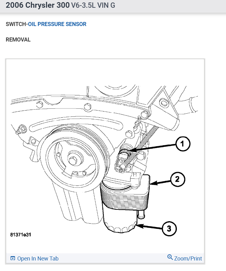

DOCFIXIT
  • 18,828 POSTS
Hi When pluged in info used Chry 300 which only comes with 2.7 that year a 300,300C,300 Limited,300SRT-8 and 300 Touring where produced. You have a 300 Limited switch is # 1 above oil filter.
https://images.2carpros.com/forum/automotive_pictures/198357_Graphic_144.jpg
That is only port to oil galley need and adapter to T off and add pressure guage and keep sensor .

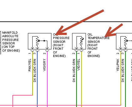

ZJYYMTGT126
My car is 5.7L and V8. Recently the oil pressure sensor(switch) is bad. The old part number is 56044777AA, and it has two connections. But it is said to be superseded by 5149062AA, which has three connections. I was wondering are they actually interchangeable? Could I use the new one to fix my car? Thank you for your help!
Jul 17, 2019 at 1:47 PM (Merged)
HMAC300
  • 48,601 POSTS
If there are only two wires then it should have two wires. I would recheck your part number they may be looking up wrong engine on list.
ZJYYMTGT126
It seems like there is nowhere to buy the old part. Could you please tell me what I should do so that I can have my car fixed? I will appreciate for your help!
HMAC300
  • 48,601 POSTS
If you go to an auto parts store or the dealer I am sure they will know what is different there are no TSB's talking about a switch change which there would be if this were the case. Try a dealer I am sure they will have something on this. I have no idea how the hook up is on the three way switch so cannot advise how to hook it up.
HMAC300
  • 48,601 POSTS
I just looked on the wiring chart and the oil pressure sensor is a three wire connector. However, the oil temperature sensor is a two way wire, you are looking for the wrong one or have told the counter person the wrong sensor.
