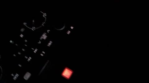

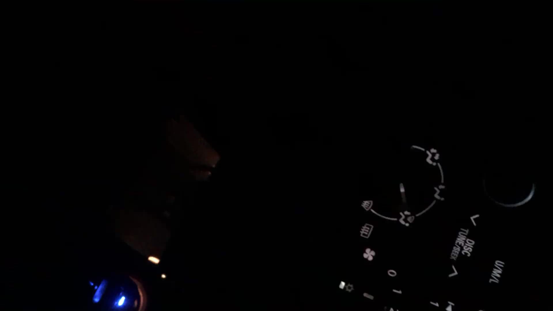

Thanks for the reply. I brought it into the place I bought it from, as it is still under a parts-and-labor warranty. There was also an occasional screeching noise from one of the belts, and when I start the car, it accelerates to about 3000 RPM's while still in park, then again when I am driving it. Sometimes I have to fight the acceleration with the brake to come to a complete stop. The car place said they replaced the alternator, which hasn't affected the chirping noise or the acceleration, but I haven't heard the screeching again since. When he was looking at the engine, the mechanic pushed on one of the hoses, which recreated the chirping noise. Attached is a video of the chirping noise when I turn or bend left.

Thanks for the video. it sounds like the noise is not coming from the engine? It sounds like there is something rubbing inside like a dash mount. can you confirm the noise is not coming from the engine?
