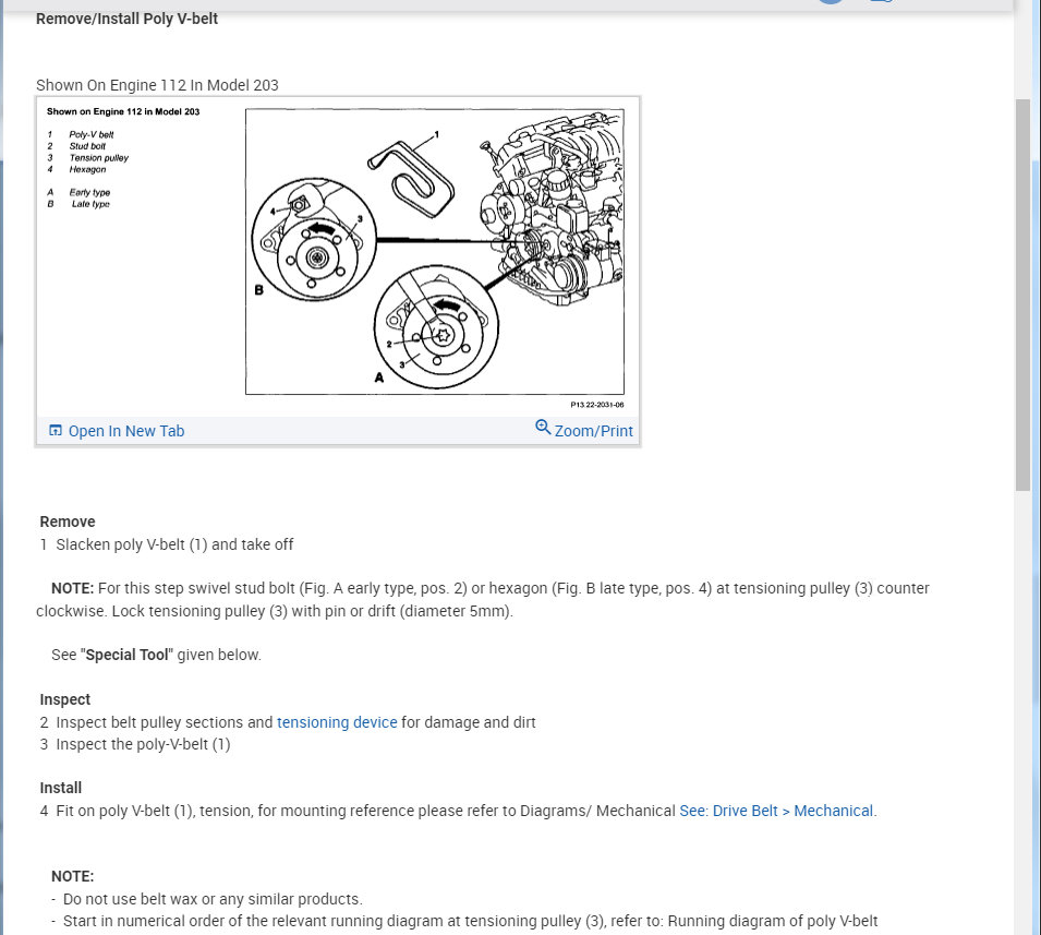

Parked in storage for 6 months. Now making chirping sound.
May 19, 2020 at 10:05 AM
More then likely this is the drive belt that is worn or dried out. We need to check the belt for cracking or just simply remove it and start the engine to see if the noise is gone. At that point, I would recommend putting a new belt on it. You can also take a small amount of dry graphite lubricant on both sides of the belt then start the vehicle. If this noise is gone and comes back a minute or two later, it is the belt. The graphite will stop a dry rotted belt from squeaking until it wears off.
Here is a guide that helps with other chirping noises:
https://www.2carpros.com/articles/chirping-noise
Let me know what you find. Thanks
