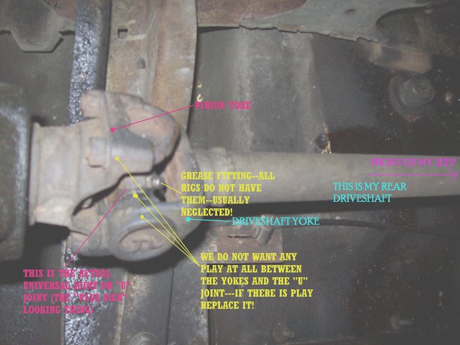

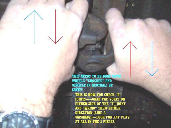

Check the "universal joints" for slop (any at all).
I have a couple of pictures that made a long while back (below). let me know if you understand them.
Return with news!
