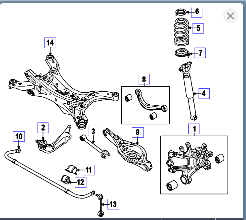

This sounds like there is another suspension component that is causing all this that replacing the rear shocks has altered or dampened the noise. So anytime you change a part, and it makes a difference to the noise then we are at least in the area of what is causing the noise.
The fact that this makes this noise when hitting a bump or dip in the road points to a suspension component and the fact that this is a chirping noise, points to metal on metal.

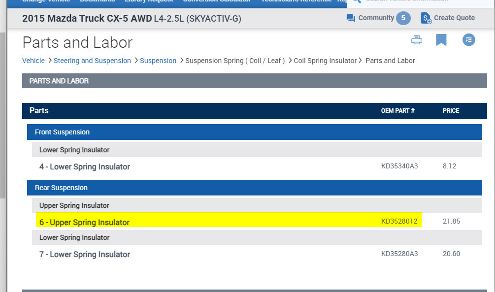

This normally occurs when these two metal parts are supposed to be insulated from each other so I would suggest starting with checking the upper and lower spring insulators.
Here is a guide that will help with these types of issues. It may not fit exactly but will give us a better idea on what we need to be looking for.
https://www.2carpros.com/articles/chirping-noise
The way to find this is to start isolating components by removing any that are able to be like the rear sway bar and then inspecting any of the rubber components for rub marks and witness marks on metal components.
Let's start with this info and then work our way through it. If you are not able to find anything, can you try to get a recording of the noise? Hearing it may help us pinpoint what the noise is. Thanks

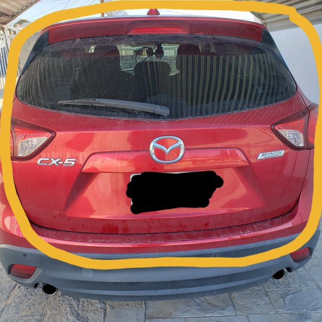

We've given it time; the heat shield was indeed making some of the noise. The heat shield was folded, and it has helped a great deal with the noise. Is there a way to open the hutch panel i believe it's called? When I open it an close there is some noise there as well.
Jan 15, 2022 at 7:12 PM
That is great news.
I am not sure I know what the hutch panel is. Can you get a picture of it and I am sure we can figure that out.

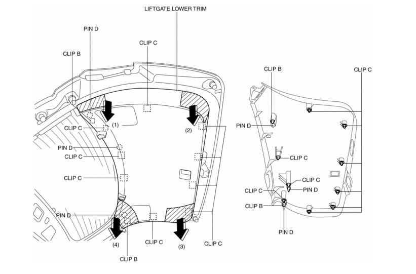

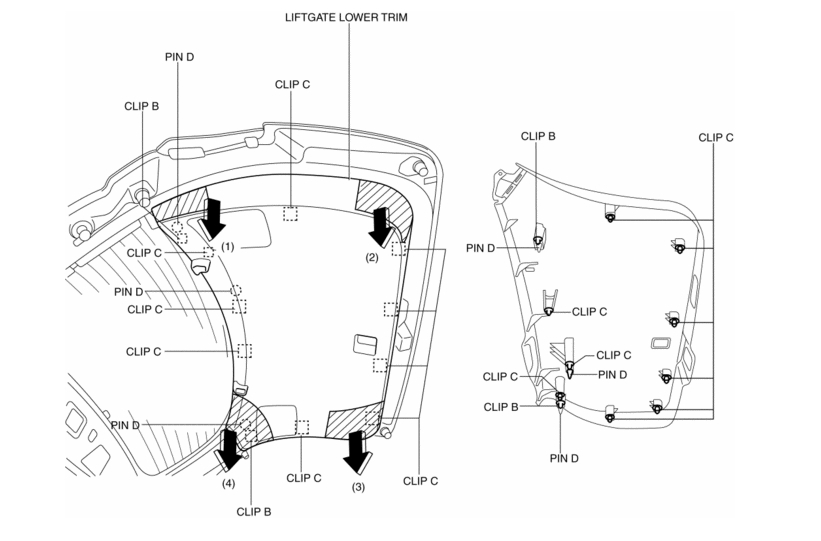

Oh. The plastic panel on the liftgate. I assume you mean the hatch as it is called sometimes.
Sorry, I should have known what you meant.
Yes, that panel just snaps in with a bunch of push pins.
You need to start in a corner and pry it up with a screwdriver so that you can get your fingers under it. Then slide them around the panel to get a good grip and give quick firm pulls down. This will start to pop the clips out and then just work your way around.
I attached a diagram that shows where they are.
