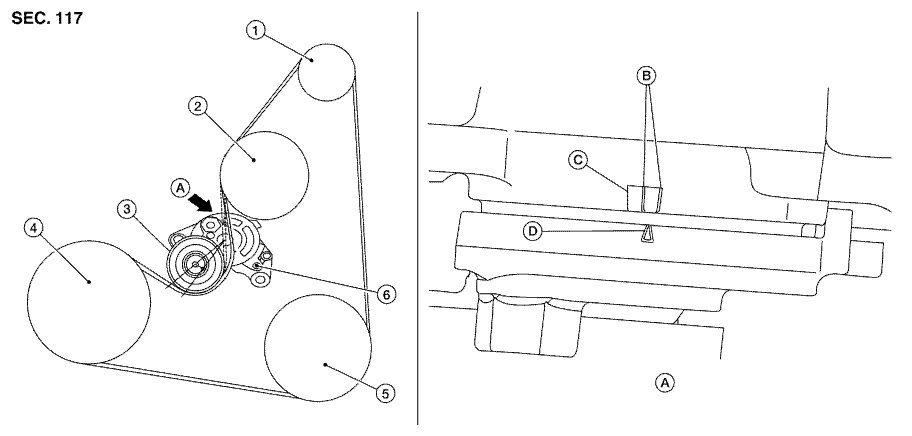

The most common issue is a worn belt. You cannot tell just by looking at a modern belt or even hoses and determine if they are worn or about to fail, unless the damage is cracking or pieces missing, that is due to the materials and compounds used today. Especially with the belts as the amount of change between good and worn out is not 1/2 of a millimeter on the ribs. On your vehicle it does have a belt range but it is more for a new belt than a used one. It is shown in the attached images.
Next most common is a weak tensioner, these are also hard to determine unless you have the specifications for the installed unit and a way to measure it.
My SOP is to use a belt wear gauge to check the belt, then if it is worn, replace it and the tension-er. While it is off I also check everything else the belt drives to avoid having other issues.
In your case I would start with replacing the belt. Then look at the tension-er to see if it is holding the belt tight enough by using the new belt notch. If it is in the notch then the tension-er should be okay.
