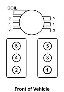

Truck runs rough at idle after plugs plug wires replaced and injectors and throttle body cleaned. Analyzer code indicates random firing of engine. Engine did not run rough before servicing, but did have a service engine light.

What plugs did you use? And are you 100% sure that you got the plug wires routed correctly? And last but not least, which engine is it? Is it the 4.3L, which is a V6, or is it a 5.7L, which is a V8? Both are available in this truck.

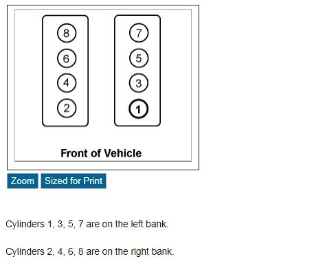

Actually I stand corrected. There is a 4.3L V-6, a 4.8L V8, a 5.3L V8, and a 6.0L V8. The first image below applies to the 4.3L V6. The second applies to all V8 models.

The truck has a 4.8L V8. The plugs and wiring were installed by a mechanic at the Tire Factory where I had my tires replaced. The plugs were AC Delco R44LTSM. NAPA Belden Edge Spark Plug Wires 700989. The checked the wires and plugs when the engine was misfiring and verified it was not them causing the random misfiring. They concluded it was something to do with the injectors that they had just cleaned. They told me to put an additive to my gas and run a tank of gas through the engine. I added put Lucas High Mileage fuel treatment in a tank of gas and ran it through the engine and it seams to be running about the same after I put about three hundred and thirty miles on the engine in one day. It is still running rough.

I hate to say this, but of course they are going to say it has nothing to do with their work. They do not want to spend the time (unpaid) to fix it. I suggest you check the work yourself using the diagram that I posted above. I also suggest making sure that each wire is fully snapped into position on both ends. A loose wire or two will cause misfiring, and no amount of poking around with the engine running in the middle of the day is going to catch it.
You really should check that yourself. If that does not solve it, then you should check the spark strength yourself. Here is a guide on doing that: https://www.2carpros.com/articles/how-to-test-an-ignition-system
