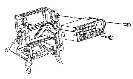

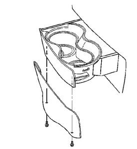

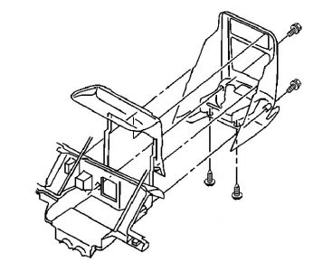

My CD player is broken I need to remove it to repair it or replace it. How do I get it out ? How can I remove trim around it ? It seems I also need to remove cup holder (ashtray) but I can't figure that out either.
Thanks for your help.
Jul 14, 2008 at 7:22 AM
SERVICE WRITER
  • 9,123 POSTS
The cup holder does need to come out. I think the exploded views will help.
