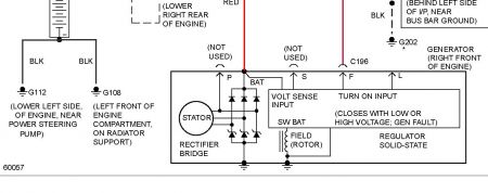

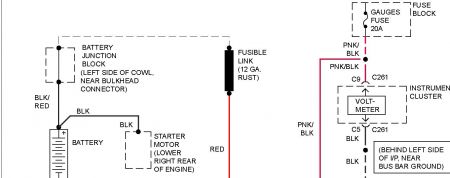

Check and test the guages fuse 20amp and all the ground points-if all ok -bring the alternator in and have it load tested-A good alternator should put out 13.5-15.5 volts loaded or not-see Charge EWD below
https://www.2carpros.com/forum/automotive_pictures/12900_a1_25.jpg
https://www.2carpros.com/forum/automotive_pictures/12900_a2_24.jpg

FIXED DUE TO THE HELP OF THE FORUM TECHS.
Heres what I did. Check battery VDC was good 12.9vdc, started car 15.9vdc at the battery.
Loaded system, still OK except the volt meter in dash showed 9.8 hummm
check battery positive and ground 9.8. Put lead back directly to battery, 15.9vdc
hummm
The ground between the engine where the battery - connects and the chassis was bad.
Small cable under cable box from battery - was broken.
