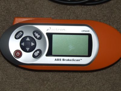

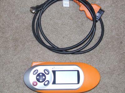

MERLIN2021
  • 17,250 POSTS
You need to scan for "C" codes, with a GM compatable scanner, generic scanner wont read the "C" codes. Having the code saves you the time and expense of replacing only the bad part. Actron now has an ABS scantool that reads ABS codes on most domestic cars and light trucks, Google Actron CP9449 I paid 114.00 fort mine, great little tool and time saver!
https://images.2carpros.com/forum/automotive_pictures/62217_CP9449_001_1.jpg
https://images.2carpros.com/forum/automotive_pictures/62217_CP9449_002_1.jpg
