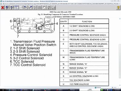

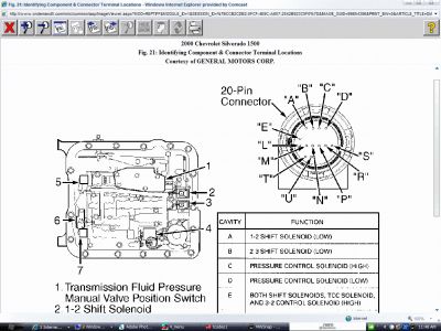

P1820 Internal Mode Switch Circuit A Low.
What does this mean? Can i fix it myself or do i need a professional?
Mar 1, 2008 at 2:40 AM
MERLIN2021
  • 17,250 POSTS

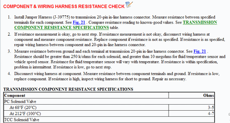

This P1820= transmission range switch A voltage low...this is what used to be called the neutral saftey switch in the old days, test the switch, and the connector...
https://images.2carpros.com/forum/automotive_pictures/62217_Test1_2.jpg
https://images.2carpros.com/forum/automotive_pictures/62217_Test2_3.jpg
https://images.2carpros.com/forum/automotive_pictures/62217_Test3_copy_1.gif
If a new switch is needed, it must be set up with a gm scantool...
