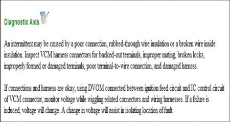

About 5 or 6 months ago I turn the key to start the truck it felt like it was going to start and died the check light came on I try again and it started and runs fine. I drove up and had the code check (P1351) drove home about 2 miles round trip check a few things under the hood seem ok drive it around and run fine and the check light went out. I have change the plugs, wires, dis. cap, rotor, ign. module at dist. new coil. the only thing I did not change was the crank sensor all this was done at 95000 miles. this has happen about 5 or 6 times now and always will start the 2nd time and run fine and the light will go out after I start it up and drive it a few times. fuel pressure is at 50-52 a little low and jumps up to 60+ as the pump runs. I have looked at the wiring and done a few test with meter and so far checks out ok. do you have some place for me to look deeper(fuel pump) or a new place to start. truck is a 2500 with 454

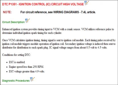

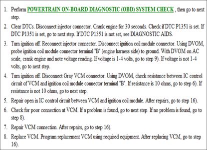

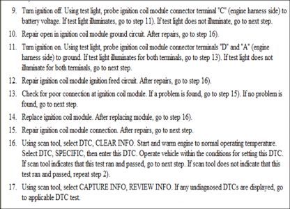

Hello - I know you have replaced some of these things....but I have attached the troubleshooting chart for code 1351. Try running some of these checks to see if the voltage etc is within the range and let's take it from there. Your right about the fuel pump.....it should be 56-62....so that may be your problem....but I would still do the above since that code was really never checked out....p1351 is ignition control (IC) circuit high voltage. By the way....thanks for the outstanding info on the vehicle....not just the model, and engine but the detailed info. Also, is the 8th digit of your VIN J?
