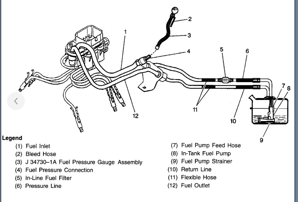

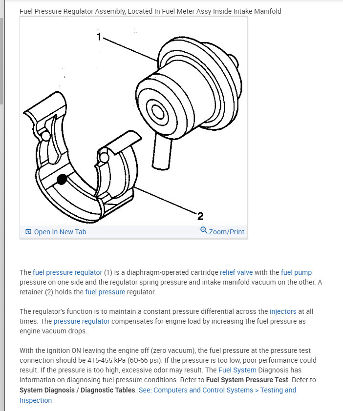

I have the truck listed above, 4.3l v-6. Where does the vacuum line from fuel regulator run to?
Monday, May 25th, 2009 AT 12:44 PM
This regulator just uses manifold vacuum. So basically, it is going to have a line running to the manifold which is most likely going to have a multiport connector for the vacuum. This means there will not be a nipple on the manifold for every connection that requires vacuum. There will be a splitter that will allow each to have manifold vacuum to each of them.
Here is a guide that helps with checking pressure which is a good idea any time you have fuel pressure issues:
Please see the info below and let me know what questions you have.
Thanks
