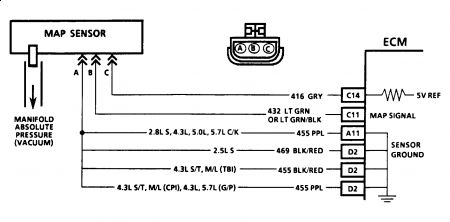

Starts and idles fine but when the throttle is depressed slightly runs rough and wants to stall did a tune up about 3 weeks ago

Was it stalling before tune? If yes check fuel pressure

Check fuel pressure 55-61 psi also maybe faulty MAP sensor

New pump and filter about 3 months ago checking map now

Unplugged map (at least I think it was) and truck ran great

If it was on right valve cover to the rear and had a hose attached that's it. And pulling hose it runs good is the test. Extra desert for you tonight

It was in the middle with two hoses

Does it have three wires? see diagram

Not sure how many wires but hose comes from the egr valve the other goes to the back of the throttle body

That is EGR solenoid so it must be opening EGR at idle stalling engine.
