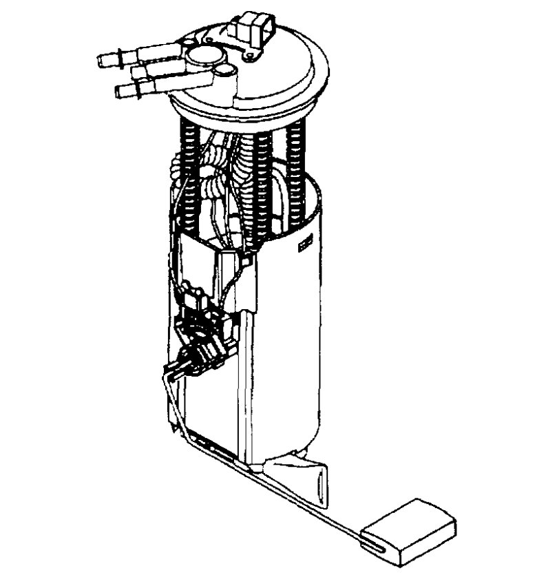

The initial problem was the truck stalled and died. The following parts have been replaced: spark plugs, wires, fuel filter, distributor, cap, rotor, pick up coil, map sensor, throttle position sensor, and idle air control valve.
The truck starts and runs fine at highway speed but when accelerating, the truck hesitates and feels like it is "bogging" down. There are no diagnostic codes (except 12) from the computer.
Any help would be appreciated.

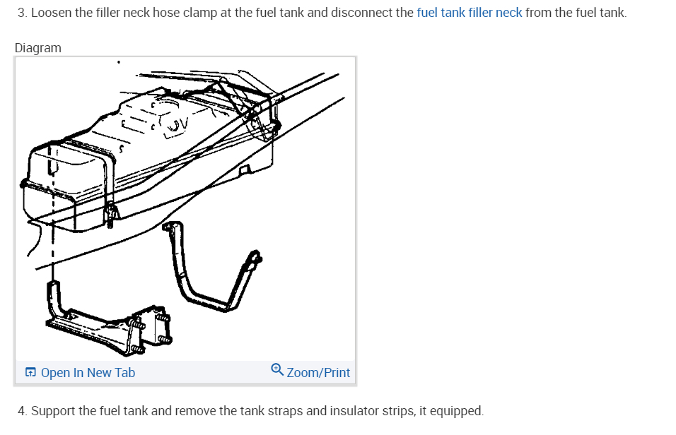

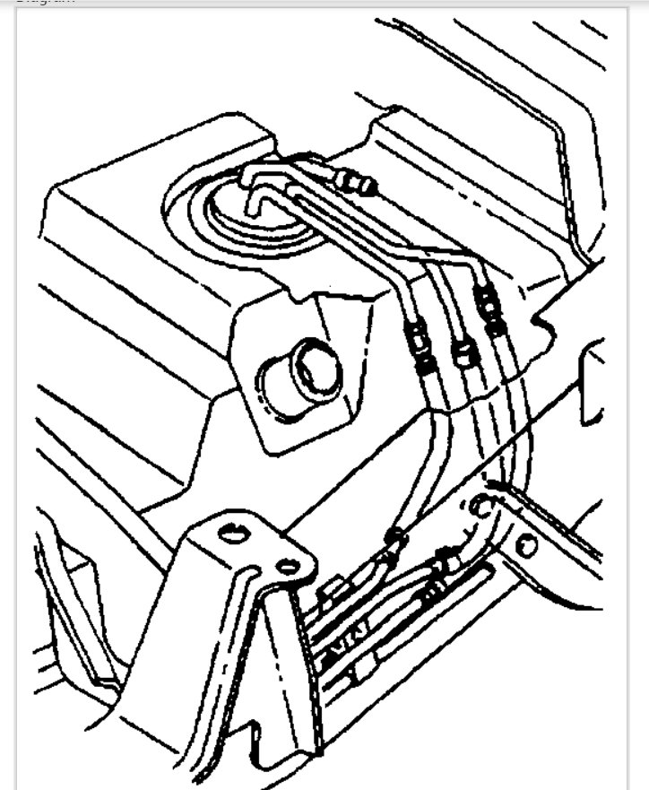

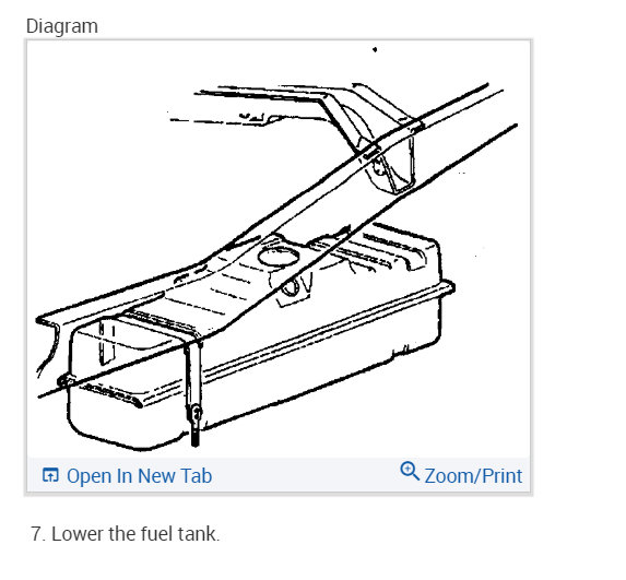

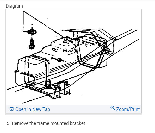

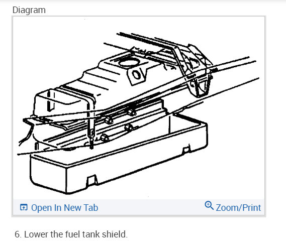

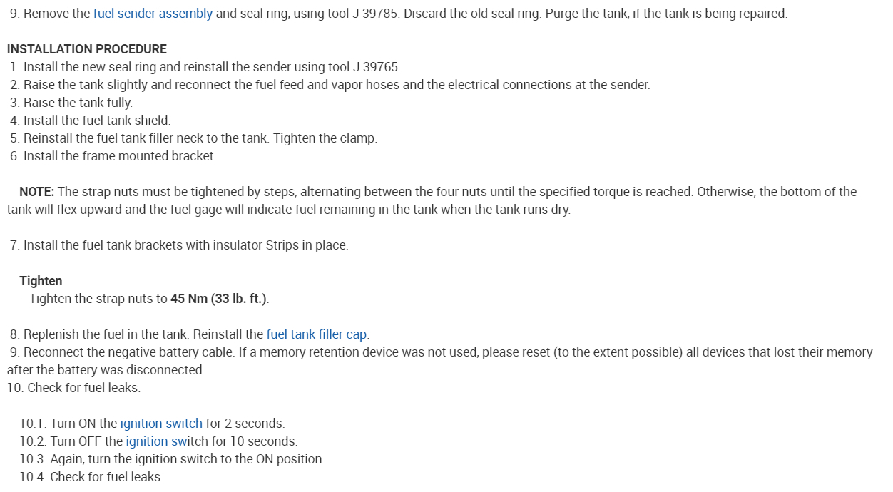

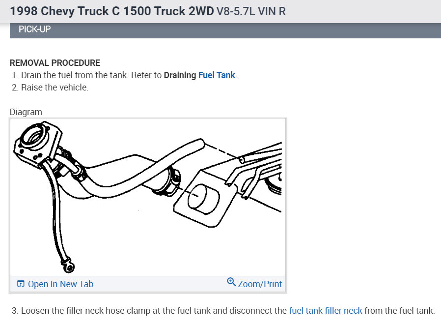

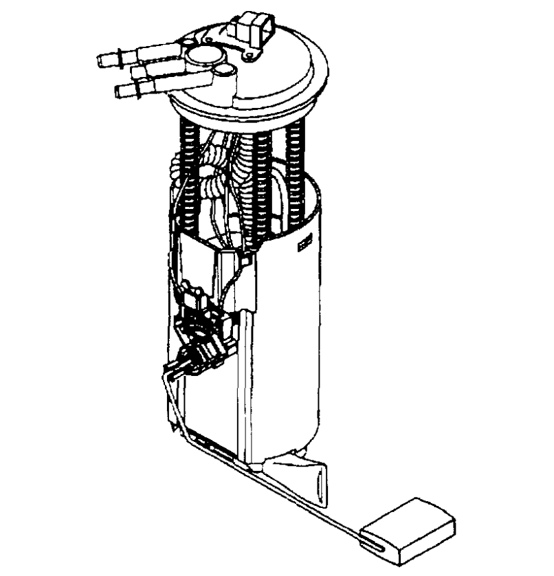

It sounds like you have a fuel pump going out but to be sure here is a guide to help you check the fuel pressure and diagrams below to show you how to replace the pump.
Check out the diagrams (Below). Please let us know what you find. We are interested to see what it is.

I got an ACdelco pump. It did the job in a couple of days the truck runs like new!
