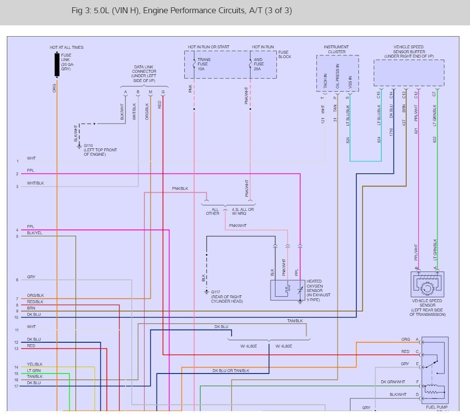

We are losing power somewhere you must have an open circuit in the system.
Here are some wiring diagrams (below) and a guide to help you do some testing.
and
Please run some tests and get back to us we are interested to see what it is. Check out the wiring diagrams (below).

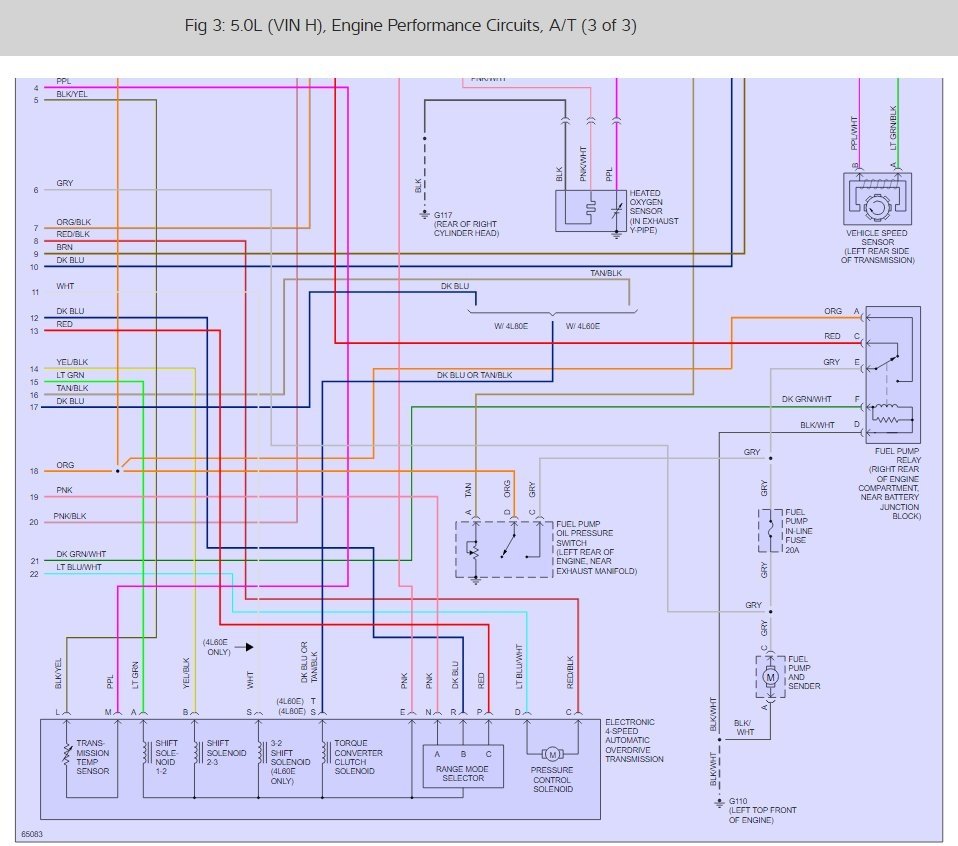

I have never gotten a peep out of the pump even after replacing all the above mentioned parts. As mentioned I can get the pump to come on if I hot wire (jump) the fuel fuse on the firewall next to the fuel pump relay. I can only get the pump to fire in this manner by using a separate power source I.E. A jumper wire from the positive battery terminal. This is the fuse wired to the relay and ECM with a gray wire. With this I assume the wiring to the pump is sound.

Okay, I have had a chance to check some things. I rechecked the pump and it fires good and pressure is +55 at the throttle body. It still will not come on with the key/ignition and the wiring checks out when I hot wire from the fuse plug near the relay. I checked power to the relay and the orange input power wire from the ECM is hot with the key on but no other coming out from the relay. Checked for good ground there/okay.
So still no power to pump! Power in to relay but none out and it is a new relay!

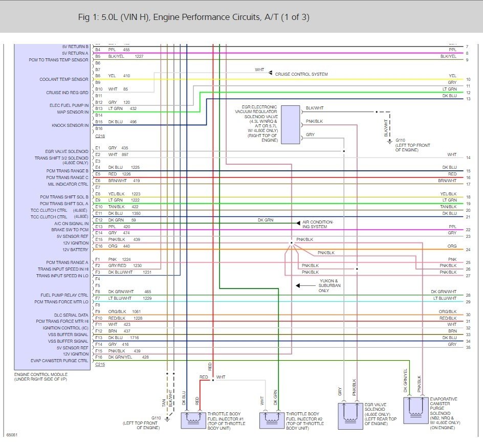

Checked power to injectors and the hot wires are hot when key is on and when the other side is grounded they will fire. I hot wired the pump and grounded the injectors one at a time and they sprayed fuel big time and the engine would start. But without manual grounding the injectors will not fire or pulse. Well I am closer but no closer if you know what I mean. I am still at a loss as to what the problem is. Why will the pump not come on and why will the injectors not fire? Please help!

Soonerbills, my truck is fixed. It was the fuel pump but once I changed it, I had to ground a contact on the test connector that specifically tells the ECM to close the fuel relay. Once the pump ran, I removed the ground and started the truck. Without doing that, the ECM did not power the relay. Go look at my post
1993 Chevrolet Truck no fuel to TBI.
There is a real good information that Merlin2021 provided and the answer may be that simple. The ECM gets it reference pulses from the ignition module to operate the fuel relay to keep it working and will shut down the fuel pump after two seconds if you stop trying to start the vehicle or there are no reference pulses. I think this will help you. Send me a post when you have success!

Soonerbills,
I forgot to mention this. In your post you mentioned the fuel relay having power on the orange wire but nothing else. Your trucks diagram probably is the same as mine. You mentioned jumping power to the fuel pump wire. If it is a gray wire, then you probably have a green/white wire that the ECM energizes the relay coil with. I use a sewing pin to pierce the wire to read the voltage when you can not get to a contact. You already changed the relay and I bet it is the ECM that is not providing voltage to power the relay because the ECM is shut down and not broke.
Do not know the electrical diagram for your truck but on mine, the coil winding is grounded on one end the the ECM applies power to energize the relay coil. When you turn the key on, twelve VDC is applies to one of the relay contacts and only when the ECM applies voltage to the coil does the contacts close and feed voltage to the fuel pump.
