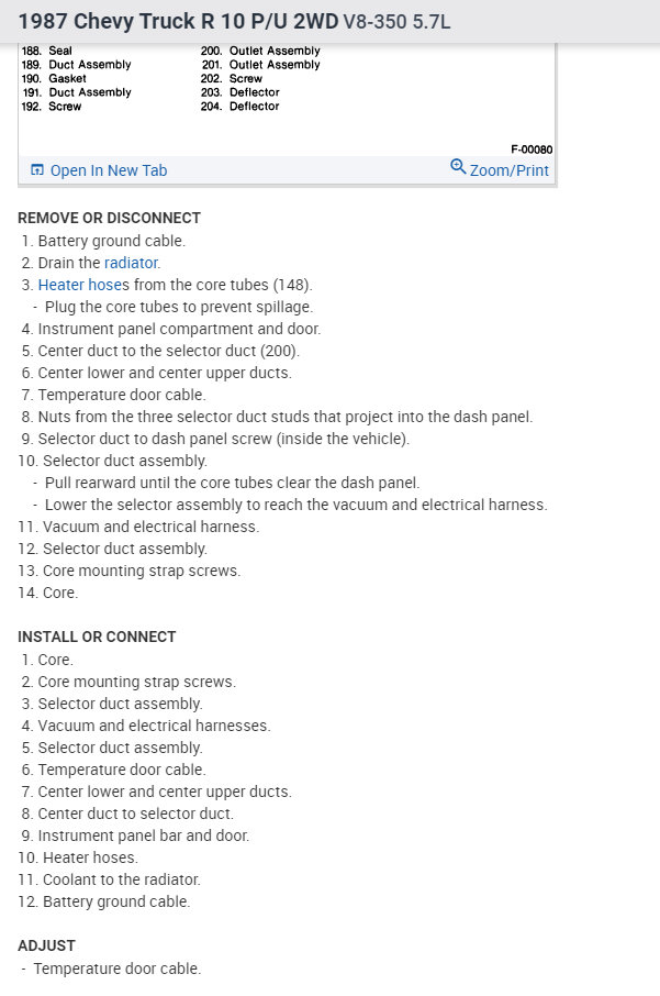

I am trying to remove the old heater core but I am having a problem?
PCON
  • 1987 CHEVROLET TRUCK
I am trying to remove the old heater core but I am having a problem getting it out Can you help?
Saturday, January 12th, 2008 AT 4:36 PM
SQM
  • 6,383 POSTS

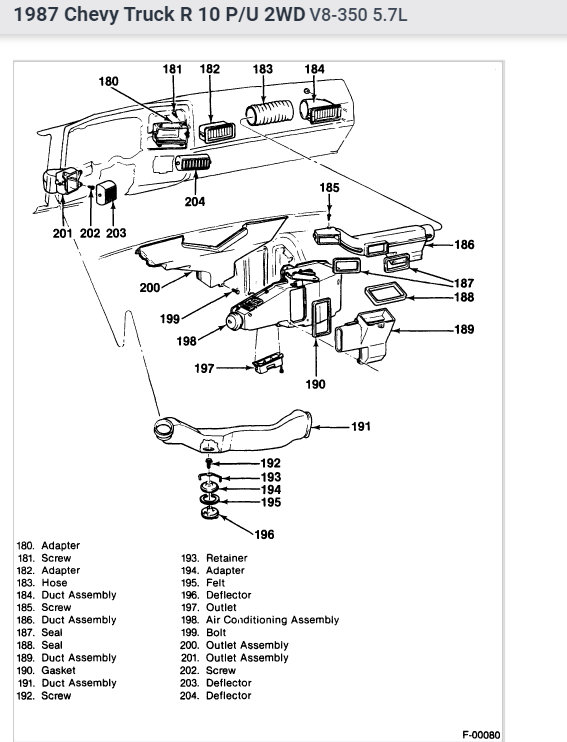

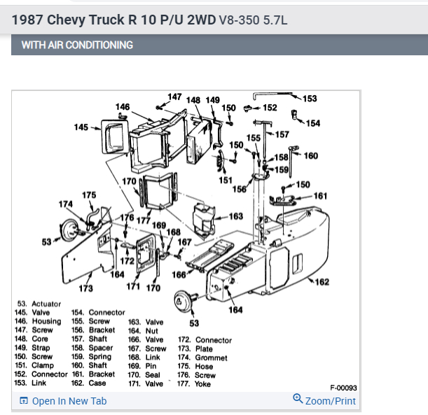

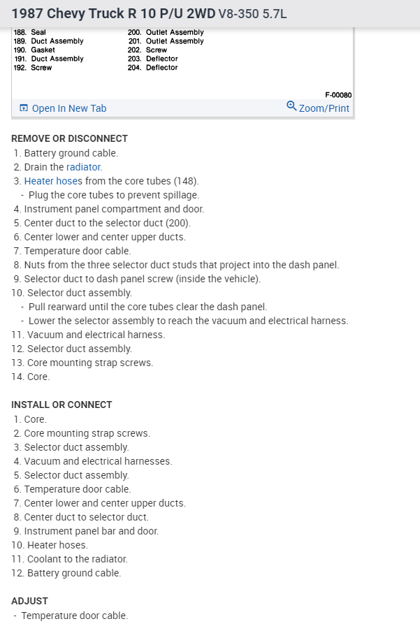

There are a few components that need to be removed, like part of the dash, in order to access the heater core and remove it.
Can you tell me exactly what issues you are facing?
https://www.2carpros.com/articles/replace-heater-core
I have attached diagrams and instructions for the heater core replacement below.
Saturday, January 15th, 2022 AT 12:56 PM
