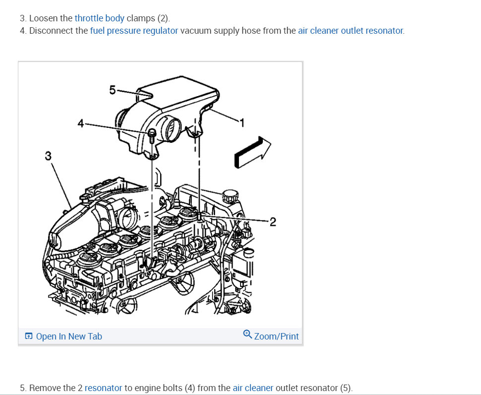

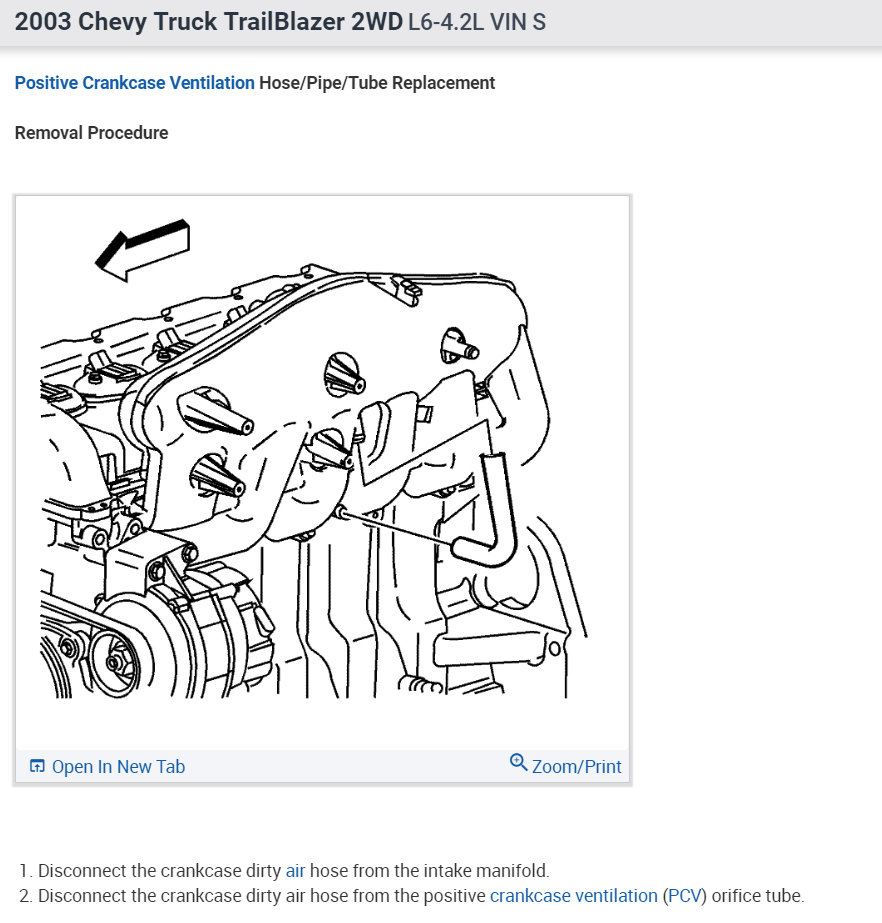

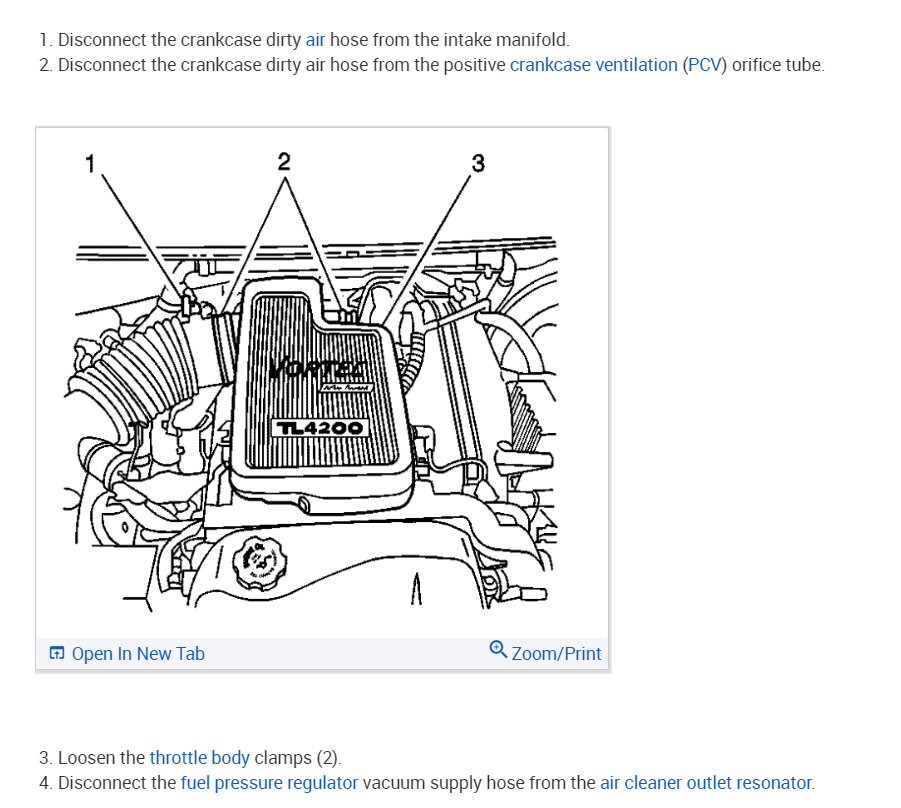

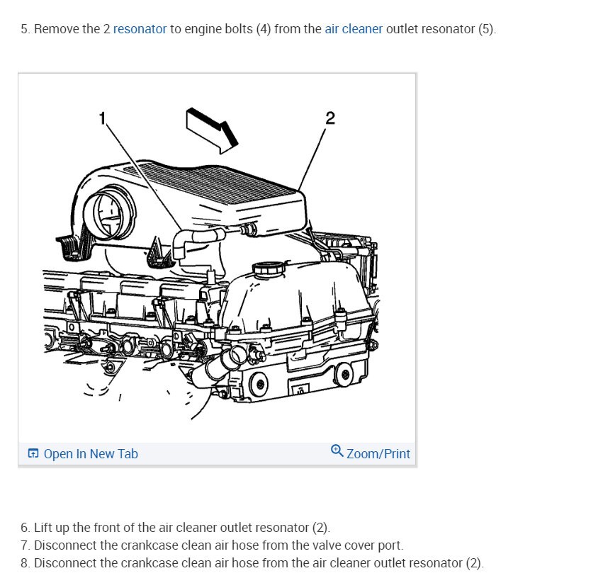

Is There a PCV Valve, where is the location?
Dec 29, 2009 at 9:22 AM
  • 75,992 POSTS
It is in the valve cover, there is no PCV valve just a feed hose, here is a diagram to show you. Check out the diagrams (Below). Please let us know if you need anything else to get the problem fixed. The valve cover acts as the PCV.
