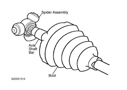

Shaking these joints can be decieving. What you're looking for is rotational movement. If there any slop at all between the 2 halves of the joint as you turn the wheel, the joint is probably bad.

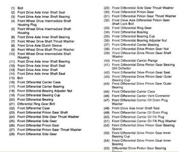

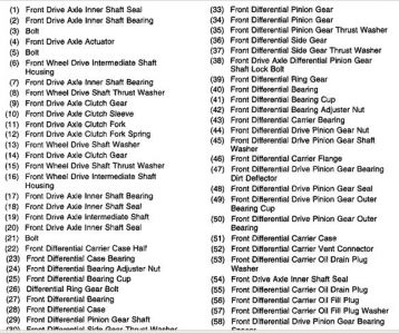

Ok, I think we're on the same page. There were 2 different front differentials used in you truck. One had a "slip clutch" system, the had a mechanical lock controlled by a vacuum actuator. Which front end do you have and which bearing are you looking at. Just give me the #, and we can go from there. I'm being cautious here 'cause I don't want to give you the wrong info.

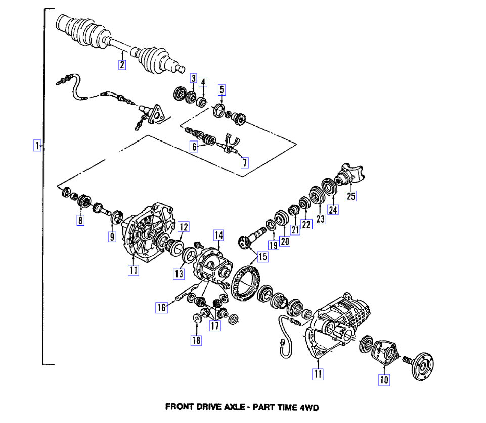

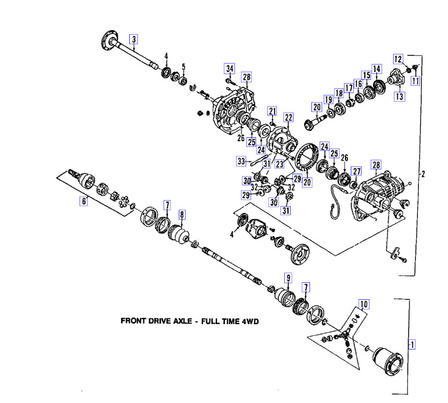

CHARLIEGIRL223
  • 8 POSTS
I have this same issue with an 03 Trailblazer thought it was wheel bearings but had someone look at it and they said differential I dont know which one I had by the 2 pictures posted HELP
+1
Thursday, March 21st, 2019 AT 9:57 AM
KEN L
  • MASTER CERTIFIED MECHANIC
  • 49,475 POSTS
Yep, the differentials can make a noise like a bearing is going out, there is full and part time systems can you control when your car goes into 4wd? If so you have the part time system. Check out the diagrams (Below). Please let us know if you need anything else to get the problem fixed.
