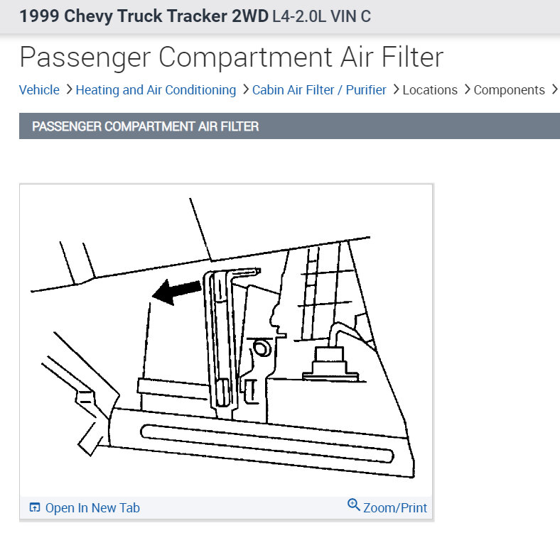

Hello. I'm getting very little air flow from the dash vents. This happens no matter if I'm using heat, A/C, or vent. There is air coming out, but it's so little it can't even come close to keeping the vehicle cool, and these are small vehicles. It's been like this for about 2 years, and I've really ran into one dead end right after another on getting it fixed. I'd appreciate any help at all, or at least a starting point.
Also, at times I do hear some squealing when I use one of the middle fan speed settings. It doesn't do it that much if it's on the lowest or highest setting. Not sure if these are related.

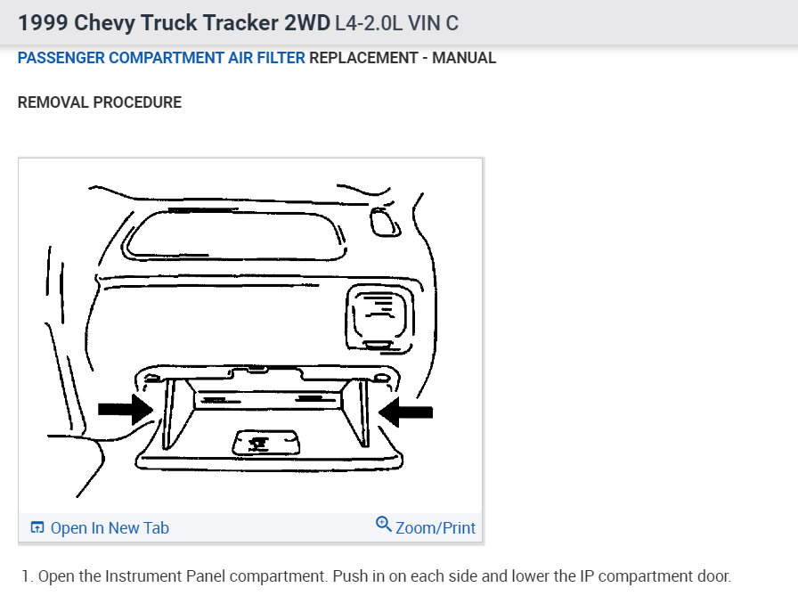

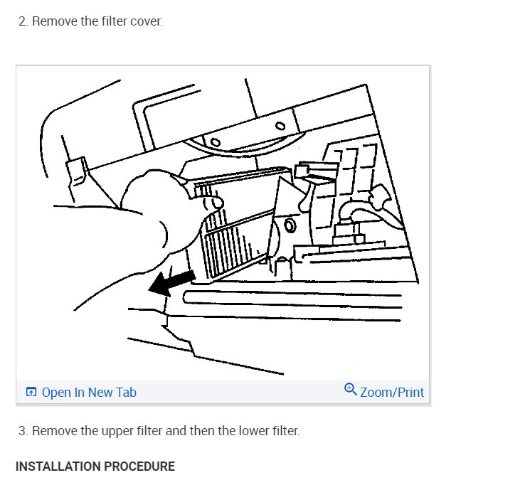

This has a cabin air filter that sounds like it is clogged. here is the location so you can fix the problem. Check out the images (Below). Please let us know if you need anything else to get the problem fixed.
