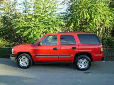

That's no problem. I'm just happy that somebody was able to give me some information, I'm in East TN and it seems nobody around here was able to figure it out. It is a strange request, most people don't want to spin their tires, but since this is an automatic trans, spinning the tires is the only fun I can have while driving it. I'll probably end up buying a late 60's 4 speed muscle car of the Chevrolet variety just so I can get out and smoke the tires. Thanks again for all of your help, I will recommend your service to anyone who asks me.
Bill Jenkins
https://www.2carpros.com/forum/automotive_pictures/154290_My_New_Tahoe_1.jpg
