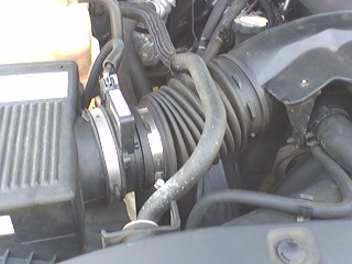

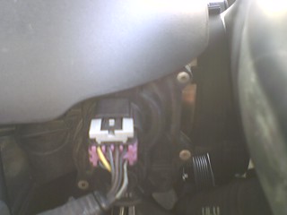

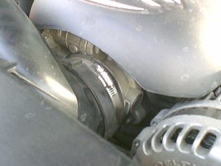

APPST8DESIGN
  • 14 POSTS
https://images.2carpros.com/forum/automotive_pictures/179747_0417081740_2.jpg
https://images.2carpros.com/forum/automotive_pictures/179747_0417081740a_1.jpg
https://images.2carpros.com/forum/automotive_pictures/179747_0417081741_2.jpg
These are areas I sprayed with carb cleaner. If I don't have an air leak would it be the MAF sensor do you think or an 02 sensor? Is pic number 1 the MAF sensor or the 3 one? Thanks again for all your help.
Apr 18, 2008 at 8:07 AM
RHALL77
  • 3,361 POSTS
pic 1 is your maf sensor. the plastic cover in the second picture, did you take that off and spray the intake gaskets with carb cleaner.
Apr 18, 2008 at 8:12 AM
APPST8DESIGN
  • 14 POSTS
No I didn't do that. I'll try that and see what happens. After taking that off will the intake gaskets be accesible without removing anything else?
Apr 18, 2008 at 8:16 AM
RHALL77
  • 3,361 POSTS
should be
Apr 18, 2008 at 8:18 AM
APPST8DESIGN
  • 14 POSTS
I removed the cover and sprayed all those areas and still no change in RPMS. I also disconnected the MAF sensor while the car was running and noticed little change besides the initial disconnect. What else do you think it could be?
Apr 18, 2008 at 12:17 PM
RHALL77
  • 3,361 POSTS
you can try to disconnect your maf sensor when it is cold and see if the engine smooths out. just an idea
