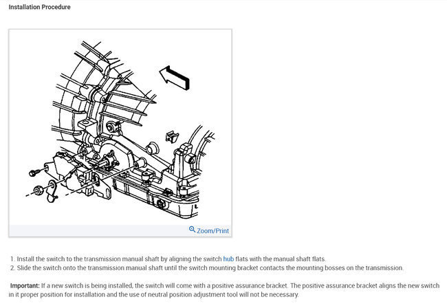

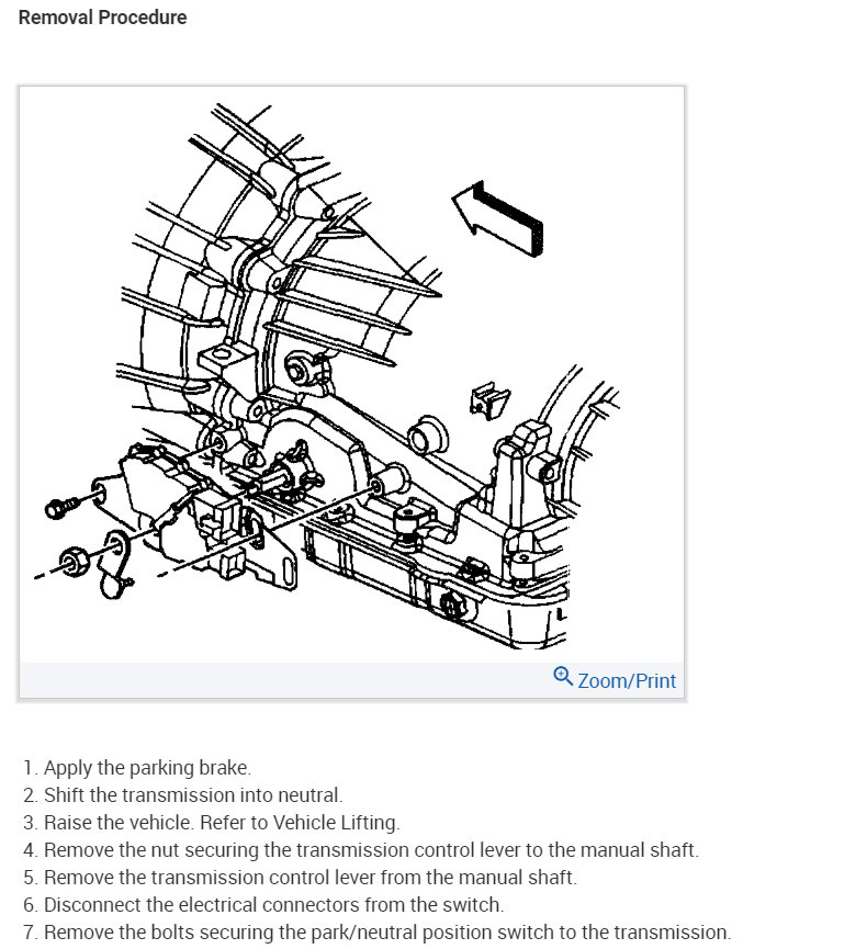

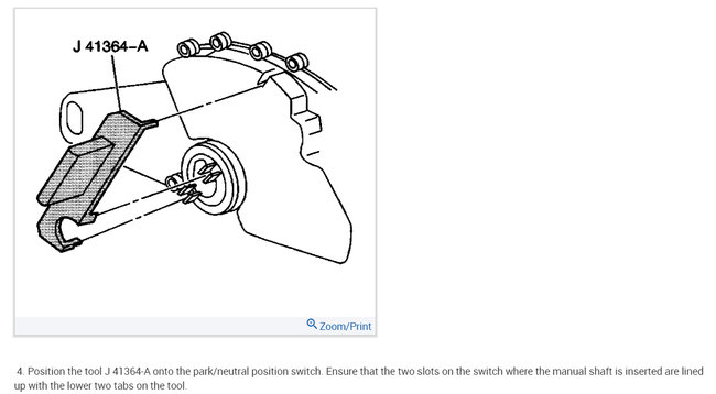

This sounds like too separate problems first the whining noise is coming from the clogged transmission filter which you can change by following this guide.
Next can you see if the reverse light work? IF not it means the transmission range sensor has gone out so the transmission does not know you are in reverse here is the sensor location so you can get it replaced.
Cheers
+9
Thursday, January 17th, 2008 AT 9:56 PM
BMWMB
Great answer fixed my truck for $67.00 I got the part for
