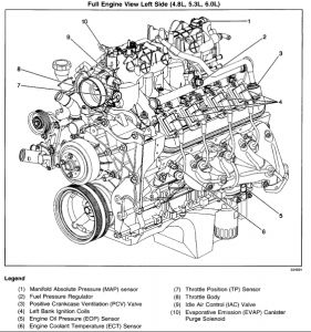

why would it run at a very high idle

Clean out the idle air control valve and see what happens

can u tell me where to find this idle air value i am a female trying to learn

The IACV is at no.9 see pic below

is there anyway u can send a larger picture of the idle air control valve where u said to clean it out i dont see anything on top of this motor we have that would look like the picture the picture is hard to see needs to be bigger if possible thanks alot for being helpful when people are short on money

Give me your email addy and I'll send it there
