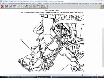

I have had my Tahoe repaired at a local shop for a misfire code on cylinder #5, replacing:
O2 sensors.
Emissons hoses.
Cap, rotor, spark plug wires, spark plugs.
Complete Injector "spider".
Fuel filter and gas cap and sea foam in a tank of fuel.
This of course was all based on computer codes and complete diag. Scans, including live mode.
Complete compression test (was good).
Now after all this and $1910.00 my truck still has a misfire problem and in fact runs worse, with a blinking service engine soon light now.
Can you suggest what to do now.

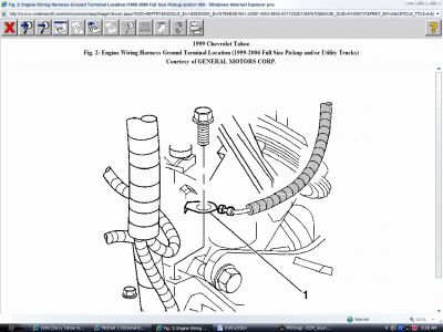

Also there is a tech bulliten on the ECM groung corroding and causing misfire codes. Remove the ground strap and clean it up, and clean the mating surface, then reinstall it, and put a sealant over the repair.
https://www.2carpros.com/forum/automotive_pictures/62217_ECM_Gounda_1.jpg
https://www.2carpros.com/forum/automotive_pictures/62217_ECM_Goundb_1.jpg
