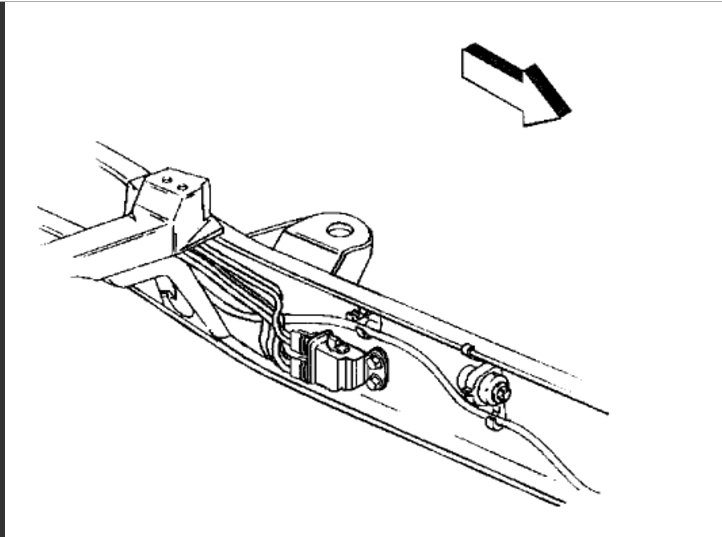

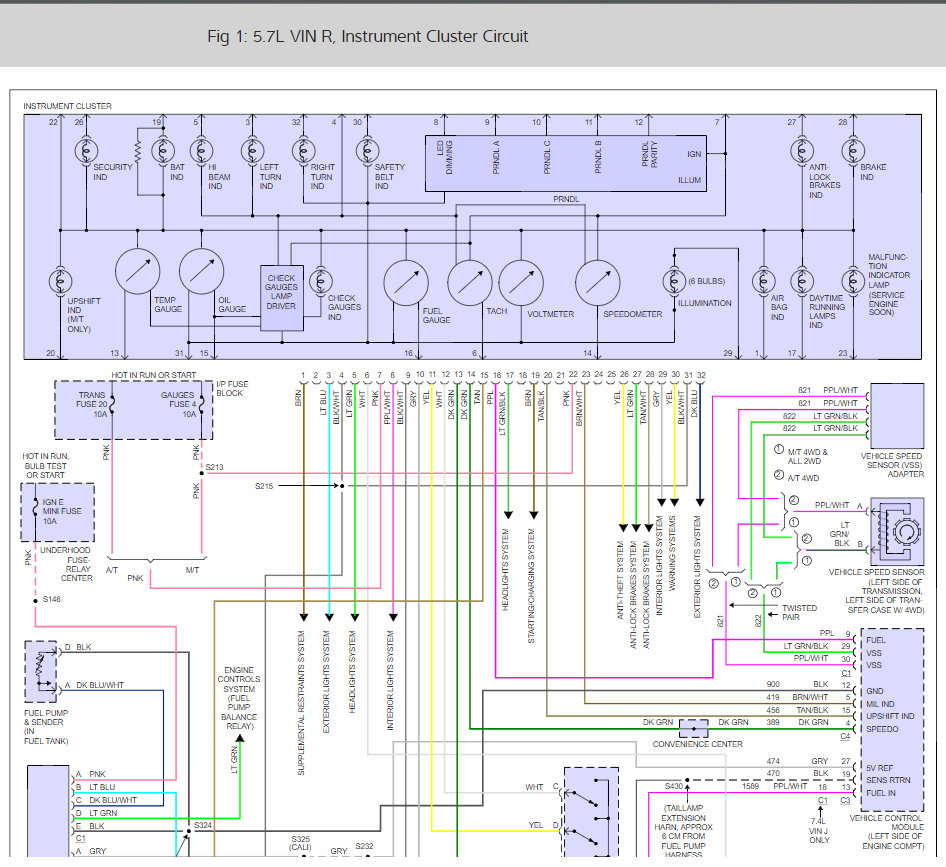

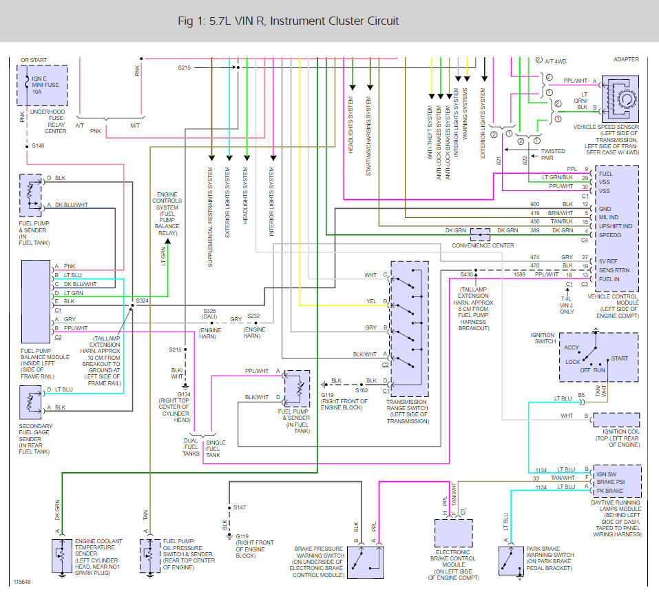

There is a fuel pump balance module that goes out in these cars, Here is a fuel pump wiring diagram and location of the module so you can test through the module do and replace the module if bad.
Please let us know what happens so it will help others.
