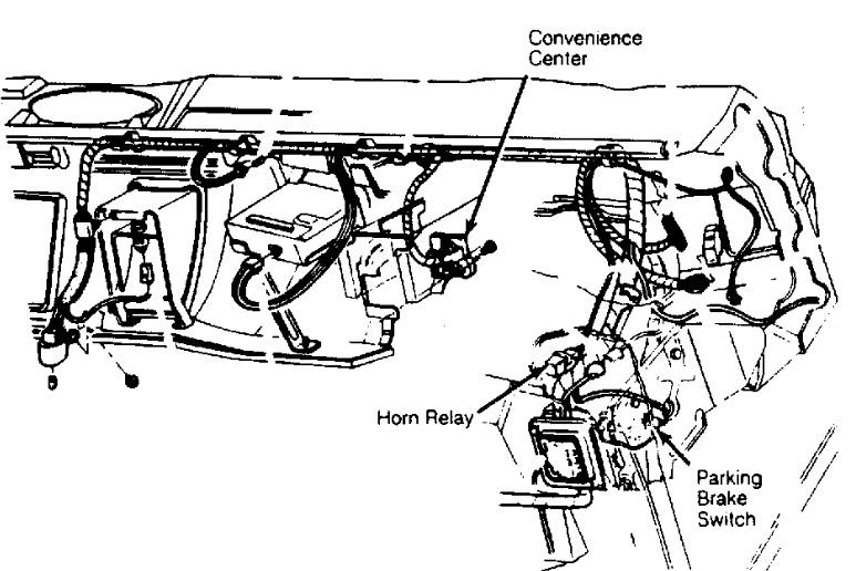

Where would the horn relay be located on the 1990 suburban?

Sorry for the late reply.
My info says it is located under the dash to left of steering column.
